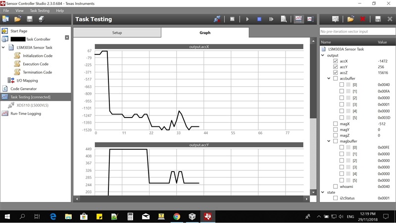

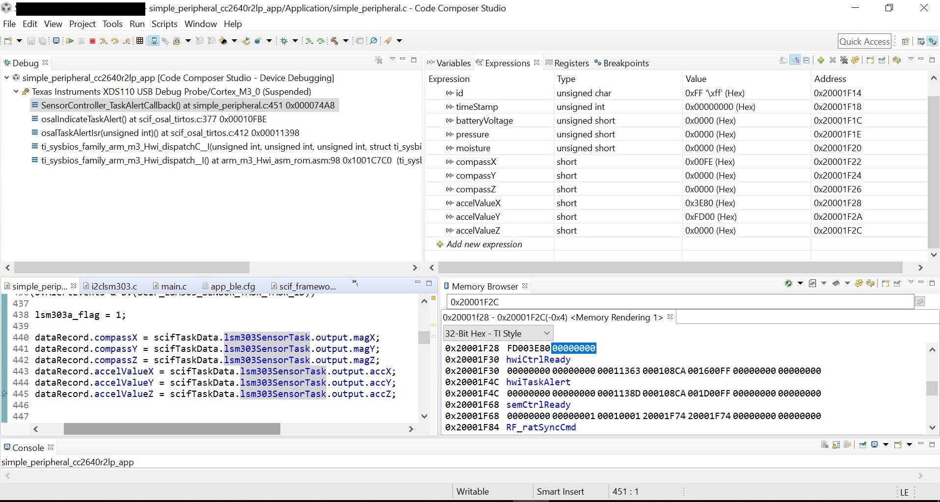

   I am using a 4x4mm CC2640R2F Custom Board with Pressure Sensor, Humidity Sensor and LSM303AGR Sensor. I am using Sensor Controller to read all the sensors. I am able to pass Pressure Sensor Data and Humidity Sensor Data from Sensor Controller to Main Application. However when I pass LSM303AGR Accelerometer + Magnetometer Sensor Data to Main Application I am getting 0. The LSM303AGR Sensor Controller Task works, see below.
When I debug at CCS I am getting 0, see below. Why does that happen? I am passing the sensor controller data to a struct at main application.

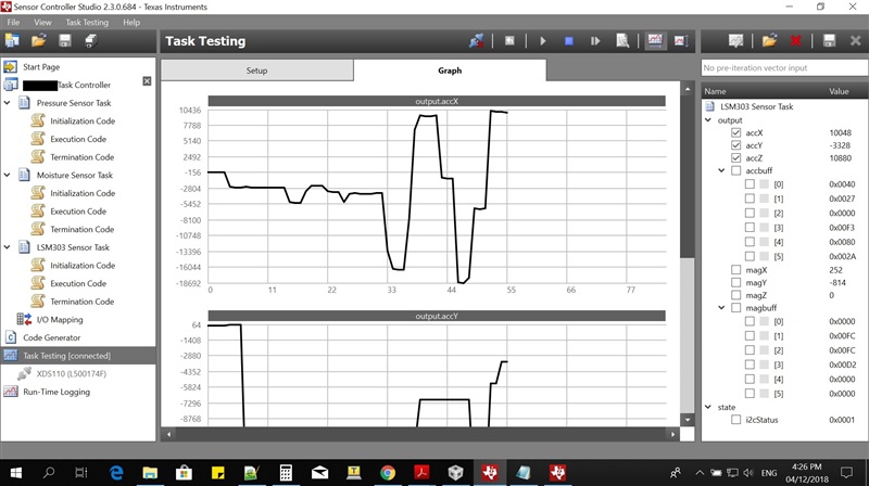

  • Hi Edvard P,
    What is weird is it works at Task Testing numerous times, then I try to change the data type of one variable then return it back to original. Now it does not work.
    -kel
  • Hi Edvard P,
        I deleted some unnecessary code at Execution Code and now task testing works every time. This is my Bluetooth Service Log. I am executing the Sensor Controller Tasks every 10 seconds the last 12 bytes are Magnetometer X,Y,Z and Accelerometer X,Y,Z. highlighted in bold

    Overall I am collecting from Sensor Controller 16 bytes of sensor data.
    At Sensor Controller my Data Structures output are as below. for LSM303A Task
    accX, accY, accZ, magX, magY, magZ - 16-bit signed decimal
    accbuffer[6], magbuffer[6] - 16-bit unsigned hexadecimal
    whoami - 16-bit unsigned hexadecimal
    output.magX = (output.magbuffer[1] | (output.magbuffer[0] << 8));
    output.magY = (output.magbuffer[3] | (output.magbuffer[2] << 8));
    output.magZ = (output.magbuffer[5] | (output.magbuffer[4] << 8));
    output.accX = ((output.accbuffer[1] << 8) | output.accbuffer[0]);
    output.accY = ((output.accbuffer[3] << 8) | output.accbuffer[2]);
    output.accZ = ((output.accbuffer[5] << 8) | output.accbuffer[4]);
    -kel

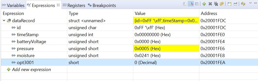

  • Have you tried debugging the application and setting a breakpoint when you read the sensor controller data that you are actually reading meaningful data?
  • Hi Edvard P,
    Yes so many times. See, the picture I shared at my first posting. But I assume it is not meaningful data because I get zeroes.
    -kel

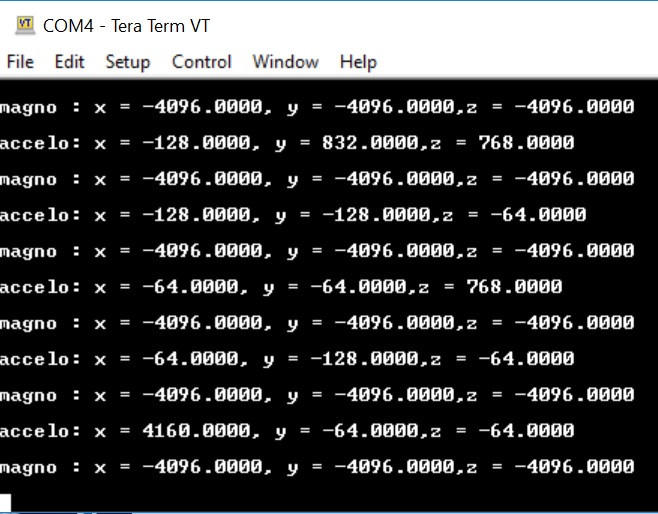

    I implemented System_printf() at Main Application. here are the LSM303DLHC Accelerometer X, Y, Z that is read from Sensor Controller. Highlighted in bold are the normal Accelerometer readings. The Accelerometer X, Y, Z will always have a positive or negative value. If I read the LSM303DLHC Accelerometer X,Y,Z at Main Application RTOS, I will never get 0 values.
    [Cortex_M3_0] accelo: x = 64, y = 0,z = 0
    accelo: x = 0, y = 0,z = 0
    accelo: x = -3200, y = 0,z = 0
    accelo: x = -11072, y = 64,z = 0
    accelo: x = -10112, y = 2176,z = 12032
    accelo: x = 1984, y = 9984,z = -14080
    accelo: x = -3648, y = 0,z = 0
    accelo: x = -4672, y = 0,z = 0
    accelo: x = -13440, y = 64,z = 0
    accelo: x = -13888, y = 0,z = 0
    accelo: x = -13888, y = 1984,z = -9216
    accelo: x = -13952, y = 0,z = 0
    accelo: x = -13952, y = 1664,z = -9216
    accelo: x = -13888, y = 1728,z = -9216
    Can I get more help regarding this from TI Engineers who are involved with Sensor Controller development.

  • Here is the LSM303 Task Execution code at Sensor Controller.
    ///////////// Magnetometer
    do{
        i2cStart();
        // Set LSM303DLHC Magnetometer I2C Slave Address
        i2cTx((LSM303DLHC_MAG_I2C_ADDRESS << 1) | I2C_OP_WRITE);
        // Set to Continous Conversion (0x00)
        i2cTx(LSM303DLHC_MR_REG_M);
        i2cTx(0x00);
        i2cStop();
    }while(state.i2cStatus != 0x0000);
    do{
        i2cStart();
        // Data output rate = 15Hz(0x10)
        i2cTx(LSM303DLHC_CRA_REG_M);
        i2cTx(0x10);
        i2cStop();
    do{
        i2cStart();
        // Set gain = +/- 1.3g(0x20)
        i2cTx(LSM303DLHC_CRB_REG_M);
        i2cTx(0x20);
        i2cStop();
    // Read Magnetometer X, Y, Z
    i2cStart();
    i2cTx(LSM303DLHC_OUT_X_H_M);
    // If successful ...
    if (state.i2cStatus == 0x0000) {
        // Read the result
        i2cRepeatedStart();
        i2cTx((LSM303DLHC_MAG_I2C_ADDRESS << 1) | I2C_OP_READ);
        i2cRxAck(output.magbuff[0]);
        i2cStop();
    i2cStart();
    i2cTx(LSM303DLHC_OUT_X_L_M);
        // Read the result
        i2cRepeatedStart();
        i2cRxAck(output.magbuff[1]);
        i2cStop();
    i2cStart();
    i2cTx(LSM303DLHC_OUT_Y_H_M);
        // Read the result
        i2cRepeatedStart();
        i2cRxAck(output.magbuff[2]);
        i2cStop();
    i2cStart();
    i2cTx(LSM303DLHC_OUT_Y_L_M);
        // Read the result
        i2cRepeatedStart();
        i2cRxAck(output.magbuff[3]);
        i2cStop();
    i2cStart();
    i2cTx(LSM303DLHC_OUT_Z_H_M);
        // Read the result
        i2cRepeatedStart();
        i2cRxAck(output.magbuff[4]);
        i2cStop();
    i2cStart();
    i2cTx(LSM303DLHC_OUT_Z_L_M);
        // Read the result
        i2cRepeatedStart();
        i2cRxAck(output.magbuff[5]);
        i2cStop();
    output.magX = (output.magbuff[1] | (output.magbuff[0] << 8));
    output.magY = (output.magbuff[3] | (output.magbuff[2] << 8));
    output.magZ = (output.magbuff[5] | (output.magbuff[4] << 8));
    /// LSM303DLHC Accelerometer Init
    do{
        i2cStart();
        // Set LSM303AGR Accelerometer I2C Slave Address
        i2cTx((LSM303DLHC_ACC_I2C_ADDRESS << 1) | I2C_OP_WRITE);
        // X, Y and Z-axis enable, power on mode, o/p data rate 10 Hz(0x27)
        i2cTx(LSM303DLHC_CTRL_REG1_A);
        i2cTx(0x27);
        i2cStop();
    do{
        i2cStart();
        // Full scale +/- 2g, continuous update(0x00)
        i2cTx(LSM303DLHC_CTRL_REG4_A);
        i2cTx(0x00);
        i2cStop();
    // Read Accelerometer X, Y, Z
    i2cStart();
    i2cTx(LSM303DLHC_OUT_X_L_A);
        // Read the result
        i2cRepeatedStart();
        i2cTx((LSM303DLHC_ACC_I2C_ADDRESS << 1) | I2C_OP_READ);
        i2cRxAck(output.accbuff[0]);
        i2cStop();
    i2cStart();
    i2cTx(LSM303DLHC_OUT_X_H_A);
        // Read the result
        i2cRepeatedStart();
        i2cRxAck(output.accbuff[1]);
        i2cStop();
    i2cStart();
    i2cTx(LSM303DLHC_OUT_Y_L_A);
        // Read the result
        i2cRepeatedStart();
        i2cRxAck(output.accbuff[2]);
        i2cStop();
    i2cStart();
    i2cTx(LSM303DLHC_OUT_Y_H_A);
        // Read the result
        i2cRepeatedStart();
        i2cRxAck(output.accbuff[3]);
        i2cStop();
    i2cStart();
    i2cTx(LSM303DLHC_OUT_Z_L_A);
        // Read the result
        i2cRepeatedStart();
        i2cRxAck(output.accbuff[4]);
        i2cStop();
    i2cStart();
    i2cTx(LSM303DLHC_OUT_Z_H_A);
        // Read the result
        i2cRepeatedStart();
        i2cRxAck(output.accbuff[5]);
        i2cStop();
    output.accX = ((output.accbuff[1] << 8) | output.accbuff[0]);
    output.accY = ((output.accbuff[3] << 8) | output.accbuff[2]);
    output.accZ = ((output.accbuff[5] << 8) | output.accbuff[4]);
    // Signalize that the task has been completed
    fwGenAlertInterrupt();
  • Can you start a debug sessions and check the return values of scifResetTaskStructs() and scifExecuteTasksOnceNbl() when calling SensorController_LSM303AStartTask()?
  • Hi Severin,
    The scifResetTaskStructs() has no return. The scifExecuteTasksOnceNbl() returns SCIF_SUCCESS.
    -kel
  • I have BOOSTXL-SENSORS with several I2C sensors on it. If I read these I2C sensors the same way and I get zero values, there is a bug somewhere in Sensor Controller.
    -kel
  • Just some sanity checks, can you verify the sensor controller project has generated code, and that the SCIF files are the latest and greatest?
    Also, when reading the values from scifTaskData, could you verify in memory viewer that the corresponding address of the Sensor Controller memory actually reports 0?
  • It is the latest. I have been using Sensor Controller for a while now, so I am familiar with the code generation.
    Here shown at bottom right dataRecord.accelValueZ = scifTaskData.lsm303SensorTask.output.accZ; with memory address 0x20001F2C shows zero value.
  • Here is Tera Term output when I read the LSM303DLHC board using TI-RTOS. There are no zero X,Y,Z.
    -kel

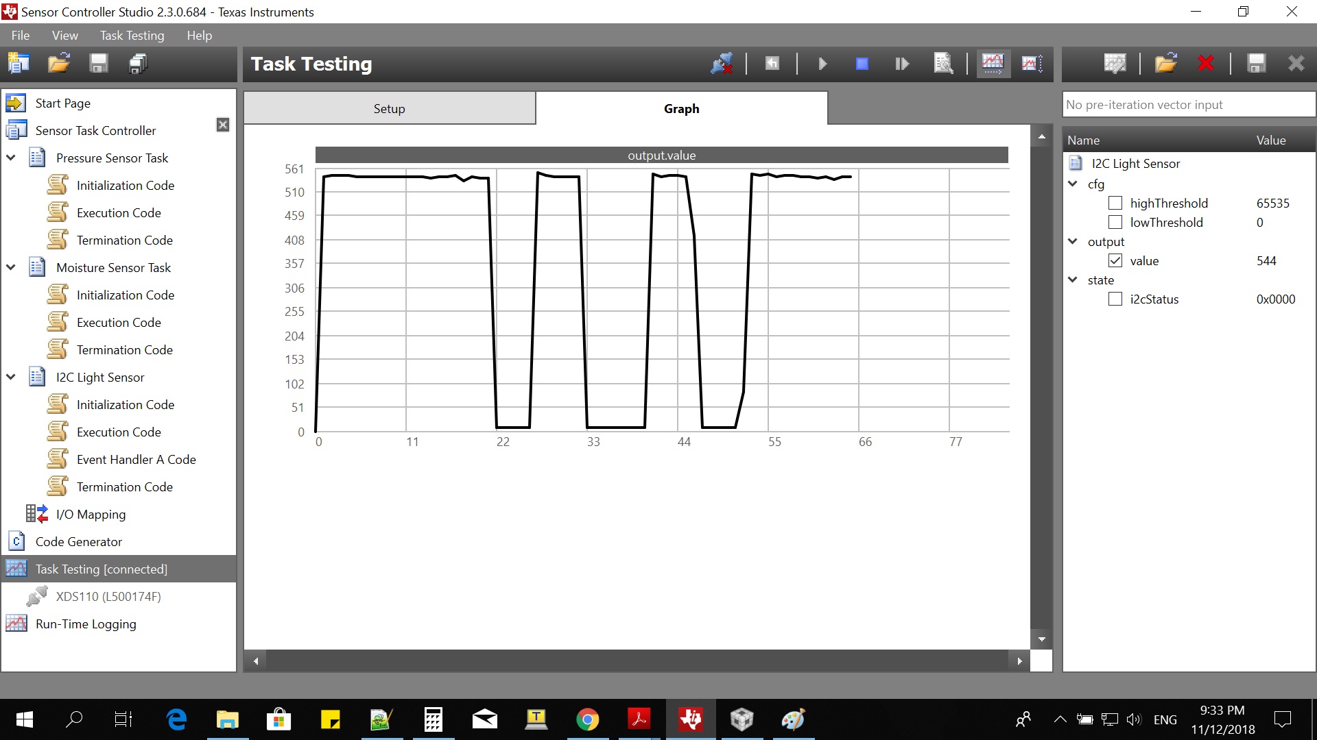

  • Hi Severin,
    I replaced the LSM303DLHC Board with OPT3001 at BOOSTXL-SENSORS. At Sensor Controller when the light lamp on my desk is on the OPT3001 reading is around 540 see, below.
    At CCS I read 0, see below.
    If you want these CCS Project and Sensor Controller Code I can give it to you through PM. I will give you a link from which you can download it.
    I would like a confirmation from TI if this is really an issue or my code implementation is not right. If this is a Sensor Controller issue then we just use Main Application TI-RTOS to read I2C Sensor. But if that is so, this statement from your document is false claiming.
    "Another use case for the Sensor Controller is to collect data and only wake the main processor for data processing. This use of the Sensor Controller offers two main benefits over using the main CPU exclusively. The first use being that since the Sensor Controller uses less power than the main CPU, the power used for collecting data is reduced significantly. When the Sensor Controller is done collecting data, it can generate an alert to wake the main CPU for processing the data"
    http://www.ti.com/lit/an/swra578/swra578.pdf
    -kel

  • Hi Severin,
    Temporarily my team decided to not use the Sensor Controller to read the I2C LSM303AGR Sensor. I re-used the CCS project that I was supposed to share to you, so I have nothing to share at the moment.
    But, there is still no conclusion to this, so I would like to keep this post open.
    From the many hours of debugging this here are my observations.
    1. Reading the I2C Accelerometer+Magnetometer Sensor using TI-RTOS main application always provide values. It never provides 0 value at either X,Y,Z
    2. Implementing the same code at Sensor Controller yields 0 values at either X,Y,Z. The cause of these 0 values from my observation is I2C error.
    I do not have I2C Logic Analyzer to show that 0 values are caused by I2C error. I have observed the same at the Sensor Controller OPT3001 example program.
    Meaning the I2C Sensor Controller performs poorly compared to using I2C TI-RTOS at Main Application. Can you verify this at TI side?
    -kel

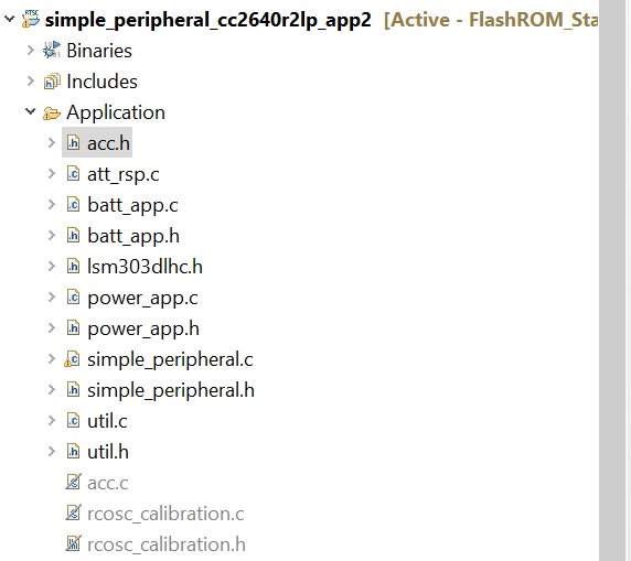

  • Ok, so I've taken a look at the code you sent, and have a couple of questions:
    * Do you use the I2C driver from the main application while the Sensor Controller task is also using the I2C?
    * If so, do you re-initialize the IO pins with the scifReinitIo() API before running the Sensor Controller task?
    * Also, would you please supply a logic trace of the I2C pins when the issue occurs.
    No.
    I do not have logic analyzer at the moment.
    -kel
  • Are you sure? When I take a look at the project you sent me, it seems like you are using the I2C driver.
    In order to determine that the issue is with the I2C, I definitely need a logic trace of the pins.
    The simple peripheral stack library CCS project I shared to you which integrates the Sensor Controller does not use I2C at main application. I do not have logic analyzer to capture the I2C signal.
    I debugged this and is really pointing to the I2C of Sensor Controller performs poorly compared to I2C of TI-RTOS Main Application. Even the OPT3001 Sensor Controller Example Program does not always give an output. I need to modify the Sensor Controller code to make it always give an output.
    I assume since you are in TI you have all the I2C sensor board  and test equipment to confirm this. If not maybe another TI Engineer can.
    -kel
  • But the simple_peripheral_cc2640r2lp_app2 project does interface the I2C driver... I'm strictly referring to Application/acc.c.
    We are unable to reproduce the issue you are facing. To me it sounds like the I2C pins aren't properly initialized or re-initialized by the main application before the Sensor Controller task is using I2C. This causes the I2C communication to fail on the SC task, which in turn provides garbage data to the main application.
    I need a logic trace in order to verify that this is the case.
    No you arrive at a wrong conclusion. You were not able to reproduce my problem because you do not have a CC2640R2F LP and BOOSTXL-SENSORS setup, am I right?. The acc.c is not part of the build. The CCS project I shared to you is for my testing so there are extra files.
    -kel
  • Ok, thanks for clarifying regarding acc.c.
    I do have the necessary HW, both a LAUNCHXL-CC2640R2 and a BOOSTXL-SENSORS. I am not able to reproduce the issue with the SW you provided. I compiled the simple_peripheral project, no modifications, and flashed the LP. I had no problem reading the values from the Sensor Controller task after I formed a BLE connection with the device. See attached picture.
