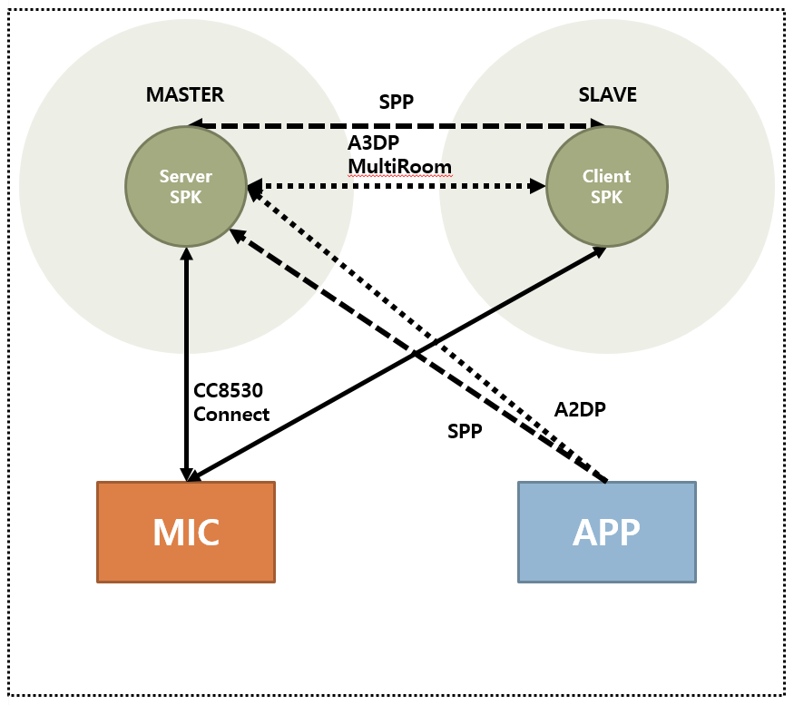

I am developing the system described in this photo and there is a serious problem with Multiroom connections.
Master and Slave connections and Source and Master connections are completely successful. (When I see the messages on the UART)
However, sometimes the Master or Slave does not sound.
Master will work perfectly with commands such as RemotePlay or RemotePause, and the slave will correctly identify the VS StreamState accordingly. But still, the sound does not play.
Attach the UART log of Master and Slave below. I would appreciate it if you could look at this log and give me some helpful information.
I have been asked by several questions to combine the demos provided by TI to create a new project that is not guaranteed to be reliable.
We understand it, and we would be very grateful if we could provide any help.
