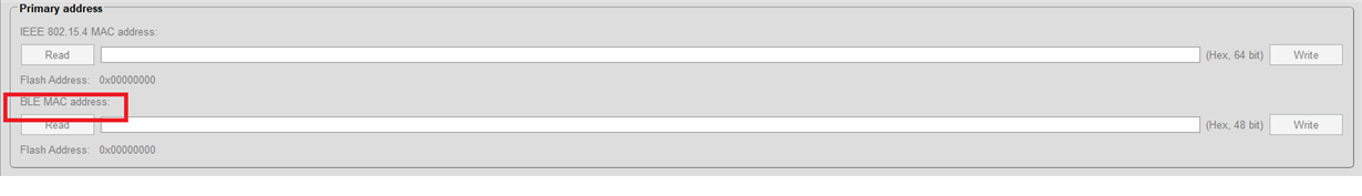

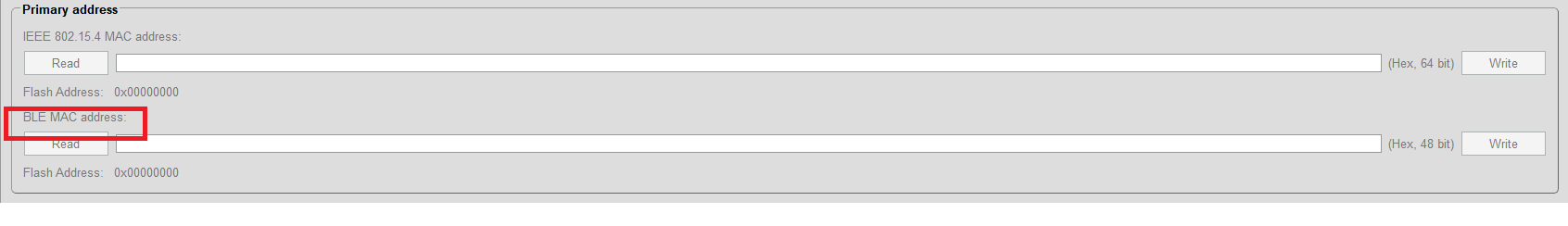

  • Hello. You are correct. The unique MAC address is the BLE address. The CC2640R2 is a "SimpleLink Bluetooth® low energy Wireless MCU" (www.ti.com/.../CC2640R2F) so that is why there is no unique 15.4 address.
    You can very this using Smart RF Flash Programmer 2 (http://www.ti.com/tool/FLASH-PROGRAMMER) by looking at the "BLE MAC Address":
