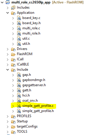

    It looks like the simple_gatt_profile.c (where you would enable notifications for characteristics), is located in the Include folder. Note that you should also install the BLE-STACK-2-2-2.

    The simple_gatt_profile.c is located under the include folder, as shown below. If you don't see it, you need to download the latest version of the BLE stack, as mentioned earlier.
