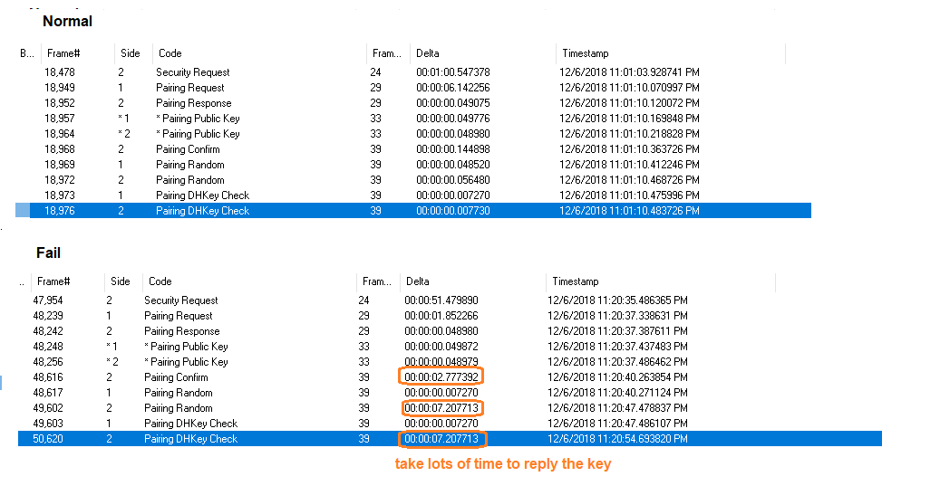

Hi everyone,
I'm using sdk_1_50_00_58, running BLE 4.2 peripheral device
I do the pairing in JUST WORK, most of the time, the pairing work fine, sometime it takes very long time and pairing fail.
Here is the sniffer record, I find that my device response the key very slow, it takes 7 seconds for random and DHKey...
Is there any way to improve , thank you!
