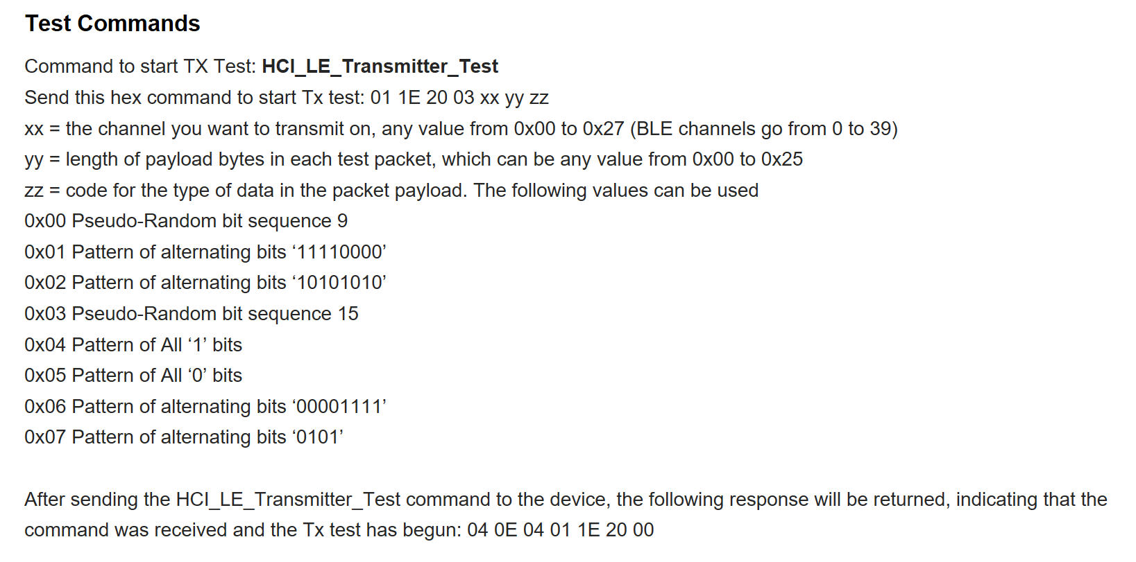

Our production equipment does not support signaling mode testing,unsignaling mode testing is too cumbersome for production.So I wanted to write a test code that would put CC2540 directly into "HCI_LE_Transmitter_Test  "mode,I see the following command, but I don't know how to write a code.Can you tell me how to write the following command as a code?
  • Hi Hank,
    Please take a look here: processors.wiki.ti.com/.../FCC_ETSI_Test
    R.M
