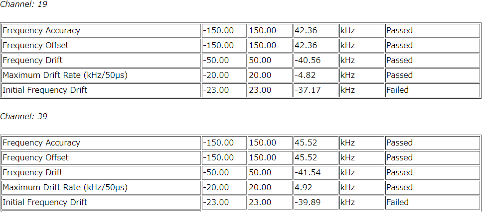

We have found that we have "Initial Frequency Drift" issue in our custom board as well as
well as the launchpad (LAUNCHXL-CC26X2R1). We are using the "ble5_host_test_cc26x2r1lp_app_FlashROM_Release"
hex file provided in the SDK.
The test shows "Initial Frequency Drift" is out of the limit.
Our custom board is based on the launchpad design, so we are sure there are no issue in the hardware/layout.
But we wonder why do we have the same issue with the Launchpad also.
Please let us know your suggestions.

  • Hi Paddu,
    Yes, this is normally related to the crystal.
    Do you have a dedicated BLE tester that you use for this test? How do you connect your board and the LaunchPad to the tester? Have you calibrated the tester?
    Also, which PHY are you using? 1M or 2 M?
    -Simon
  • Hi Simon,
    Thank you.
    Yes, we have dedicated BLE tester and I believe the connection is as per the application report(SWRA530)
    I am not sure about the Calibration.I will get back to you with more details about the setup details.
    Just in case I have sent you the test report.
    With regards to PHY, it is used with default settings (1M?).

  • Hi Paddu,
    You are currently evaluating engineering samples of the IC with preliminary RF settings. As you know this is not material that can be used for certification, and you cannot go to production with this. As such it is expected that the RF settings are not optimum and may have sub-optimal performance in some aspects.
    Final revision of the IC is currently in the process of being made available for sampling, this should happen sometime early Q1. Fully characterised settings with robust performance will also be released before RTM.
    If everything else in your design checks out, layout, crystal parameters, etc. Then I suggest you wait until you get final revision samples before pursuing this case any further.

  • Hi Paddu,
    There will be no support for revision C material in new SDKs after revision E is released, this has been stated in various terms and agreements the customer has accepted when ordering samples and kits.
    As you can see from Simon´s reply further up we are not seeing the same issues on the LaunchPads. What test equipment are you using?
    The engineering samples are provided for evaluation and start of development, but not for certification and mass produciton. As such they will potentially have minor issues and less optimised performance. Slightly missing the frequency drift requirement will have no noticeable impact on range or ability to interoperate and should thus not be a limiting factor for neither evaluation or development.
