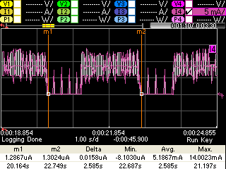

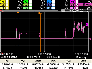

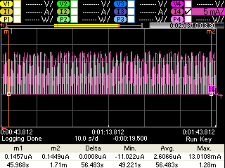

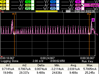

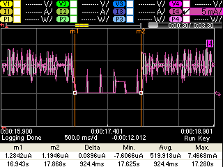

    I modified my codes following your suggestion and it did work. I tested the power consumption and it can achieve about 1.5 uA when static.
    But there's also new problems, during idle (i mean the device is not scanning), there're unknown current peaks which is about 8 mA. Data are from keysight N6705 at sampling period 0.02048. Pic:
    pic 1 illustration: since i'm using scan period 2*1.28s = 2.56s, scan duration 160*10ms = 1.6s,the pic above shows the scan parameters are running correctly, but the front part, which i would like to name it part A, should be in low-power status but there are unknown current peaks, information about the peaks below:
    pic 2 illustration: there are 4 peaks in the pic, the current varies from about 5 mA to 8 mA.
    pic 3 illustration: under some situations, there are unknown active behaviors too, detail about it:
    pic 4 illustration: it's about and 3.2mA (what kind of active operation could cause such current? it's like MCU's awake) and lasts about 150ms.
    pic 5 illustration: as to peak numbers, it's not fixed to 3 or 4, in fact, it's changing, right after initialization, there're about 7 peaks and as the device runs, it finally decrease to 2 peaks, the current is at the same level.

  • Hi CL,
    As for the small spikes you see, I would assume these to be the recharge pulses, these are to be expected.
    As a reference, you can take the pinStandby example and perform the measurements on that when in standby. You should see periodic small spikes in the same way.
    As for pic 3-4, the small 150ms period of 3.2 mA looks like the device is waking up for a small amount of time to perform some calculation. This is close to impossible to guess on what it could be, but most likely there is some clock set to expire at that time in the application. Can you see this pulse more then once, and in this case, is the period between the two static? If that is the case, you might be able to deduce what clock it might be by looking into ROV when debugging.

    Thanks to your guide, i have made it! I need to make sure one thing, are all spikes in the pic below used for re-charging?
    pic 1
    avg current:
    pic 2
    In order to get more detailed data, i measured interval and spike current value, here are them:
    interval: 447.5ms  434.4ms  477.9ms   312.8ms   495.3ms   417.1ms   495.3ms   417.1ms
    spike current: 12.96mA  10.14mA  10.87mA  12.46mA  11.17mA  7.6mA  12.56mA  13.00mA  9.99mA  11.01mA  12.4mA  11.03mA  7.79mA  12.61mA
    Both interval and spikes seem various, i can't draw obvious rule from these, how could i tell apart re-charging spike and others? Or in what situations, we can make sure that a spike must be a re-charging spike?
    Regarding the left part in your answer,calling UART_readCancel() would lead to truncating the data and losing part of it, so is there anyway to get status of the receiving event before it's done? If so, i would delay the action of uart_close, and receive a complete frame successfully. As we know, even if there's length byte if the frame, losing data would cause discard, communication for this time is ruined.
    Thank you for your time, learnt a lot from you.
  • Hi CL,
    The looks like re-charge pulses, they are adaptive to some extent, so the duration between two pulses could vary.
    You could tell it is a re-charge pulse by the length from it, as waking up the RTOS takes a significant amount of time, causing a wider pulse.
    Also, try measuring the avg. current from the end of a pulse (low level) to the end of the next pulse (basically, 1 idle interval + 1 pulse).
    Regarding UART, there is no good way to know that the read is currently active. You can do a direct access to the UARTCC26XX_Object structure (be careful wen doing this as it is not meant to be accessed outside of the driver) and look at the "readCount" that should indicate how many bytes you have currently read.

    I'm sorry that this thread can't be closed, because today when i measure power consumption of my board with connected to the host board (they are connected by uart), i find that only if i connect them together, the power consumption would rise.
    Here are data:
    board                                                    static avg current         periodic avg current (including the RF action)
    my board only                                            1.5uA                                 93uA
    board+emulate uart connected                 2.0uA                                  113uA
    board+emulat uart+hw uart connected     4.9uA                                 130uA
    and pics:
    I have made the uart tx pin as normal ios and output high with pushpull, the rx pin as input pin with interrupt and pullup.
    The host device has also made tx and rx pin with pullup.
    An increase like the emulate uart is acceptable, but increase about 2~4 uA is too much.
    Do you have any idea about this?
