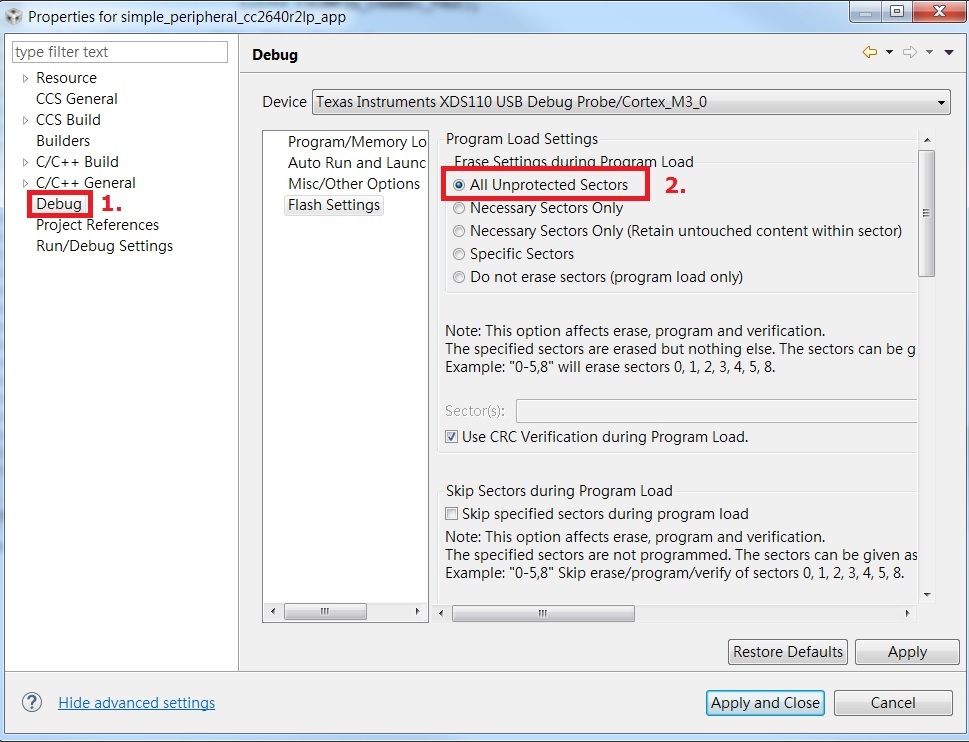

using flash programer 2 to erase all unprotected pages, then debugger could load file again.
is there a way to configure emulator in ccs to erase the soc before load file to resolve this problem?
