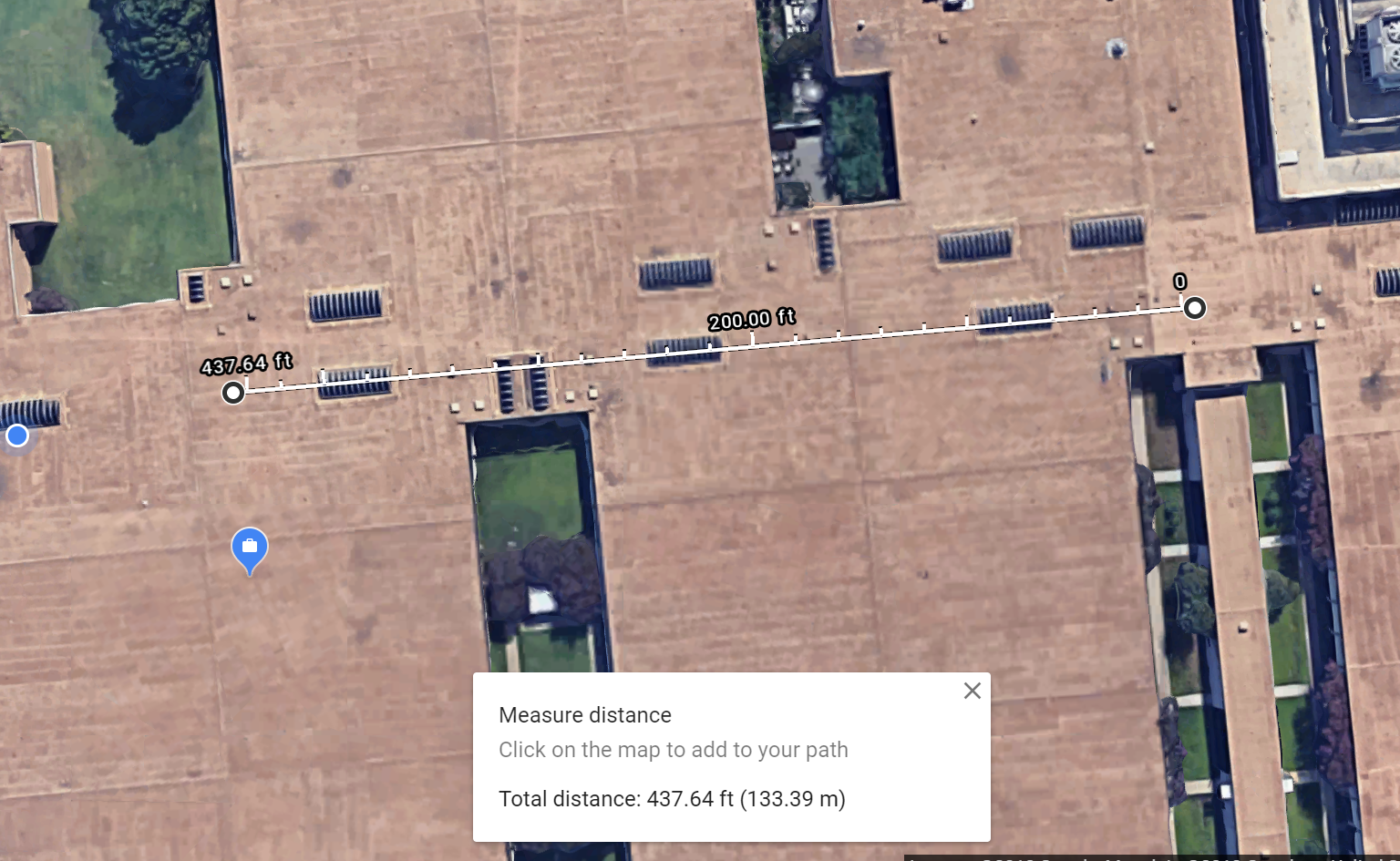

  • Marco,
    Could you please let me know what Coded PHY you are using? S = 2 or S = 8?
    What distance are you seeing when you refer to a range of 1mbps?
    Kris
  • Marco,
    I tested the simple central and simple peripheral from the simplelink_cc26x2_sdk_2_30_00_34 sdk and had great luck with it.
    I have a set of instructions for you to test out.
    Materials
    2x CC26X2 LaunchPads
    2x USB
    1) Download the SimpleLink CC26X2 SDK v2.30.
    2) Connect LaunchPad A to computer.
    3) Start Uniflash
    5) Click start for the device that is plugged in and click browse and navigate to C:\ti\simplelink_cc26x2_sdk_2_30_00_34\examples\rtos\CC26X2R1_LAUNCHXL\ble5stack\hexfiles and flash simple_peripheral by clicking Load Image.
    6) Start a new session and disconnect LaunchPad A
    7) Connect LaunchPad B and navigate to C:\ti\simplelink_cc26x2_sdk_2_30_00_34\examples\rtos\CC26X2R1_LAUNCHXL\ble5stack\hexfiles and flash simple_central
    8) Connect LaunchPad A to another power source (like a portable battery or another laptop).
    9) Start a PuTTy session for LaunchPad B running the central project.
    a. Enter COM port settings (can be found in device manager) and for baud enter 115200.
    10) Click reset to see the device menu.
    11) The menu system uses the buttons on the launchpad. The left button is for doing an action where you see the “<” symbol. The right button is for the “>” symbol.
    12) When both devices are connected to power,  click the left button once to navigate down to “Discover Devices” and click the right button once to start discovering devices.
    13) 1 device should be discovered, click the left button twice to navigate down to “Connect To” and click the right button.
    14) Click the right button once again to connect to the device with the displayed BD Address.
    15) This will connect the devices and pair the device.
    16) Click the left button twice to go down to “Work With” and select the device you wish to work with.
    17) Here you can navigate to a number of options such as GATT Read, GATT Write, Start RSSI reading Connection Update and Set Conn Phy Preference. Navigate to the Set Conn PHY Preference and select Coded in that menu.
    18) Coded will automatically use Coded S=8 of the coded PHY giving you the longest range. The device will return a status of 0x00 and give the message “BD Addr: PHY updated to CODED”
    19) You can confirm that this is using the Coded PHY by using a BLE 5 capable sniffer like an Ellisys to see that the device is in fact using a coded session. I’ve confirmed this myself with this project before.
    If you would like to clean the traffic up even further we can make changes to the oob examples instead of using the prebuilt hexfiles.

  • Kris,
    thank you a lot. I was able to move 200m away from the simple peripheral(Street was only 200 m long). I still wonder why it didnt't work.
