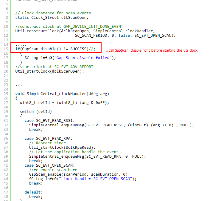

My design is using simplecentral as a pure listener, it would start scan periodically, to lower power consumption, i wanna stop scanning after gets specific data and start a timer at the same time. After the timer triggered, in the callback function, it would start scan (call GapScan_enable). If the device fails getting data wanted, it would stop scan after the duration (set by users) and start again in next scan period (i set the device with infinite mode).
When it comes to my code, i find that the device runs to error when calling GapScan_enable in function registered to util timer. My codes:
#define SC_EVT_OPEN_SCAN 0x0B
#define SC_SCAN_PERIOD 8000
// Clock instance for scan events.
static Clock_Struct clkScanOpen;
//construct clock at GAP_DEVICE_INIT_DONE_EVENT
Util_constructClock(&clkScanOpen, SimpleCentral_clockHandler,
                          SC_SCAN_PERIOD, 0, false, SC_EVT_OPEN_SCAN);
if(GapScan_disable() != SUCCESS)//;
    SC_Log_info0("Gap Scan disable failed");
//start clock at SC_EVT_ADV_REPORT
Util_startClock(&clkScanOpen);
void SimpleCentral_clockHandler(UArg arg)

    case SC_EVT_OPEN_SCAN:
      //re-enable scan here
      GapScan_enable(scanPeriod, scanDuration, 0);
      SC_Log_info0("clock Handler SC_EVT_OPEN_SCAN");
      break;

    I debugged and found the program was stuck here when running into GapScan_enable:
    uint32_t icall_directAPI( uint8_t service , icall_lite_id_t id, ... )
      va_list argp;
      uint32_t res;
      icallLiteMsg_t liteMsg;
      // The following will push all parameter in the runtime stack.
      // This need to be call before any other local declaration of variable....
      va_start(argp, id);
      // Test that the API is not called in a Hwi or Swi context
        BIOS_ThreadType threadtype = BIOS_getThreadType();
        if (threadtype == BIOS_ThreadType_Hwi ||
            threadtype == BIOS_ThreadType_Swi)
    #ifdef HALNODEBUG
    #else /* ! HALNODEBUG */
          ICall_abort();
    #endif /* HALNODEBUG */
    It finally runs into ICall_abort(); which is a dead loop.

  • HAHA, you should ask me earlier, i call GapScan_disable here:
    It's called right before starting the clock and re-enable when clock triggered.
    You can see the codes in the beginning of the post.

  • Hi
    I solved this problem by chance, since i have ran out of ideas, and i saw other events in the util event callback, they're so simple, they never put complicated things here, just put task in queue. This inspires me, i add my event to appmsg event and process it in SimpleCentral_processAppMsg and then it runs well.
    I haven't find out the difference, but i'm about to post this question.
