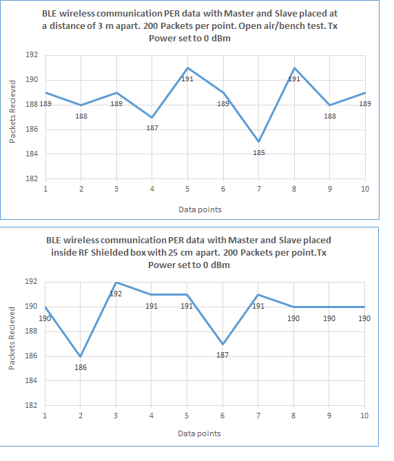

I am using BLE CC2650 launchpad as Master and Slave. External command containing Advertising interval, required packets and advertisement duration is given to Master via UART. The master then connects to the slave and writes the required advertisement interval and duration to the characteristics of the slave and then connection is terminated. The slave then starts advertising with required adv interval and duration and master keeps a count of the packets received and calculates PER(Packet Error Rate) accordingly at the end of adv duration. Please find the below graphs for testing done in open area and inside RF shield to observe the PER.The RF shield image-STE2300 is also attached below.
I want to know why there is almost no difference in PER calculated when testing is done where both boards are kept outside and when kept inside RF shield.
