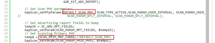

  • Hi Fredrik
    Thanks for your answer, it helps.
    In fact, i'm trying to realize a design that advertising about 100 bytes and covering the largest area at the same time, but things about LE Coded phy and extended adv confuse me, i can't tell them apart very clearly.
    Here i would past my code here, please help me check whether my code satisfies my needs.

          // Set Scan PHY parameters
          GapScan_setPhyParams(DEFAULT_SCAN_PHY, SCAN_TYPE_ACTIVE,SCAN_PARAM_USER_INTERVAL, SCAN_PARAM_USER_INTERVAL);
      //                         SCAN_PARAM_DFLT_INTERVAL, SCAN_PARAM_DFLT_INTERVAL);
          // Set Advertising report fields to keep
          temp16 = SC_ADV_RPT_FIELDS;
          GapScan_setParam(SCAN_PARAM_RPT_FIELDS, &temp16);
          // Set Scanning Primary PHY
          temp8 = SCAN_PRIM_PHY_CODED;//DEFAULT_SCAN_PHY;
          GapScan_setParam(SCAN_PARAM_PRIM_PHYS, &temp8);

    There is only SCAN_PRIM_PHY_CODED, no option that clearly points to S=2 or S=8.

    The above are my codes. Is it correct corresponding to my design?
    And in my last post, i mis-spell a word, what i want to ask is, if i use LE Coded phy and LE 1M phy, after the connection's created, what phy would the devices in connection use to communicate?
    Thank you for your time and looking forward to your reply.

  • I have found the problem.
    There's conflict in parameter settings, default scan phy is not coded phy. After i make default scan phy coded phy, the code runs well.
