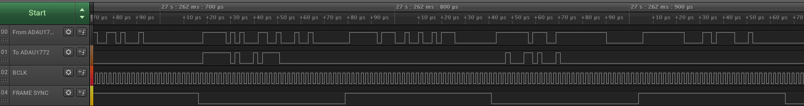

To address some of the I2S timing issues that seem to occasionally corrupt the second Audio stream in one direction, I've tried making the ADAU1772 the I2S master.  But it just refuses to produce 16-bit audio data (I'm working with ADI to troubleshoot this).  So, a quick workaround might be to get the CC2564 into 24-bit mode so they play nice.
This is a logic analyzer capture of the current interface with an ADI ADAU1772 connected to the CC2564MODN showing the data mismatch.

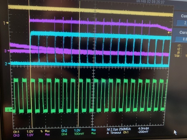

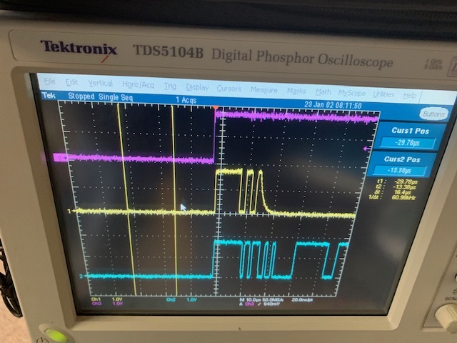

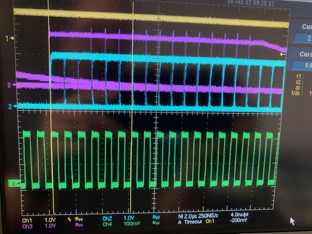

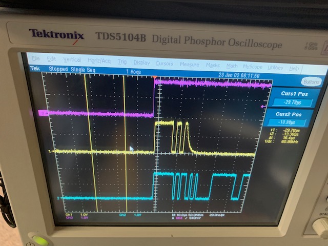

  • Alright so I think I have the codec configured a bit better, but the CC2564MODN is not driving the audio bus low at the end of the 16-bit frame.  The ADAU1772 codec does not support 16-bit mode because the CC2564 requires a wait block in between audio channels, and so I am afraid the drooping line is occasionally being picked up and interpreted as lower-order bits of noise.  We've also observed the codec's automatic gain control getting confused and begin stuttering unexpectedly.
    Attached is a waveform showing how the CC2564 is just letting go of the line (yellow trace) of its 1 channel of 16-bit audio data.  The blue trace is both channels of the 24-bit ADAU1772.
    And this is with a 10K pulldown added on.  We will try with a 1K pulldown, but a better solution would be for the CC2564 to correct it by driving the line to the correct state.
    Thank you,
    - Jason
  • Well using a 1K I was able to get the droop almost completely gone, but the out-of-sync remains.
    When in Dual SCO mode I have clear audio going on both input and output channels. But occasionally the phone connected on the second SDO channel will flip out and begin a rapid loud click. If I tell the codec driving both channels of audio to the CC2564 to mute/unmute that channel, clicking goes away, but could come back later. A workaround has been to mute/unmute the codec every second and then this isn't really a problem, but that would be a horrible way to resolve this.
    The I2S data all looks properly formatted during this time, so I am wondering if this might be the result of the CC2564 not keeping up? Ever seen anything like this before? The audio to the CC2564 from the phone, and the audio channel to/from the first SDO connected device are all clear during this time.

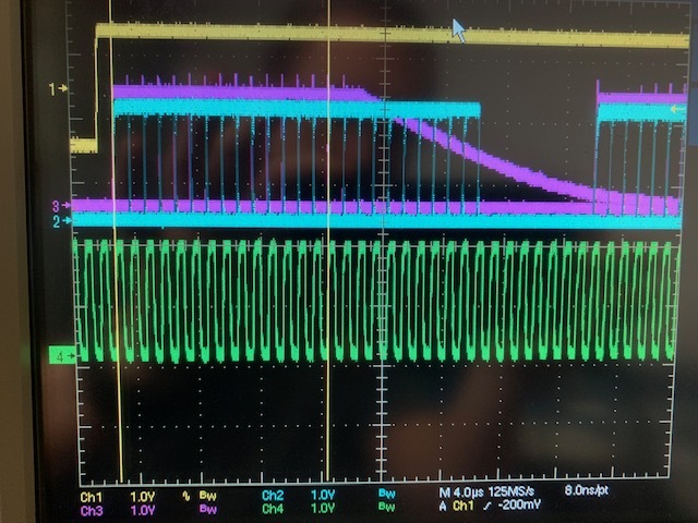

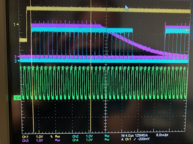

       Attached are some additional screen captures showing the left channel and right channel.  Yellow is FSync, Green is BCLK, Purple is the CC2564MODN and Cyan is the ADAU1772 codec.  These were taken with persistence on to better illustrate the edge transitions, and I used a vertical cursor to flag the rising edge transitions.
       Please note the CC2564 in purple is just letting go of the line and not zeroing it out as would probably be helpful... and this is with a 1K pulldown added.
       The right channel (phone) where we are having the issue has one artifact in that screaming into the phone fails to change the 3 highest order bits.  But screaming into the ADAU1772's mic input does toggle the highest order bits.  Not sure what might be causing that, but it isn't directly related to our issue as the Audio quality from the phone is fine.  It is only audio to the phone that becomes corrupted.
    Can you please elaborate on the 1K pulldown? The I2S/PCM pins on the CC256x already have an internal pull-down. Please refer to pin attributes in the device datasheet for details. Could you please double check that your system design complies with the reference schematic provided in the datasheet (and EVM design files)?
    Vihang
  • Hello Vihang,
      If you are referring to the schematic Figure 6-1. Reference Schematics, then yes... we have single traces with no other components connecting the AUD_* signals from the CC2564MODN to the Codec.  Both parts are 1.8V logic so no need for isolation or level translation.
       On multiple designs with multiple I2S interfaces from the CC2564MODN to other codecs and MCUs we've observed the Audio Out signal failing to settle quickly after an audio transfer is complete, despite (as you can see from the scope capture) where the edges are clean and transition fast during data delivery.  Only when the output goes High-Z does the I/O takes time to settle.    What value internal pulldown is present?  The datasheet did not seem to specify it.
    Our designs do not have an additional pulldown in them, as we were relying on the CC2564MODN's internal pulldown.  But, given the issues we were having we decided to mod one in to try and clean up the line.  Can't quite make it work though.  If the pulldown is weak (100k?) there may be too much gate capacitance to discharge in a few microseconds?
    - Jason
    The internal pull-down is a weak pull-down. The value is somewhere around 90K to 120K.
  • Ok, that would match our measurements and explain the scope captures.  I believe the CC2564 should be driving the IO low after the audio bitstream is completed - to match the behavior of our other codecs.  Letting the weak pulldown slowly take care of things is insufficient for higher BCLK rates.
    We are working with ADI to better understand the pin capacitance of their CODEC and better evaluate what size pulldown will be needed to address this.  But again - this is not related to or involved in the noise issues we are having.  It is just an observation of something that could be improved.  They are also working to duplicate our setup and perform further testing on the ADAU1772.  Hopefully we know more soon.
