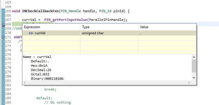

I hope you are doing well. I need to set 8 pins in open drain + pull up mode and Set it output. Can I read write port? Which pins I can use as port? any example code?
But I can't see the usage of
I need to see example code in which both of above functions are used.
I am trying to read data on parallel port and sending it on uart. Trying to develop parallel to serial interface.

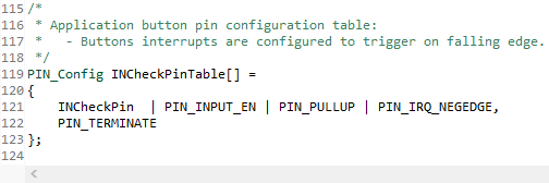

Parallel Pins Config, Wanted to set open drain ,pull up, and set as OUTPUT
PIN_Config parallelPinTable[] = { ParallelBit0 | PIN_GPIO_OUTPUT_EN | PIN_INPUT_EN | PIN_OPENDRAIN, ParallelBit1 | PIN_GPIO_OUTPUT_EN | PIN_INPUT_EN | PIN_OPENDRAIN, ParallelBit2 | PIN_GPIO_OUTPUT_EN | PIN_INPUT_EN | PIN_OPENDRAIN, ParallelBit3 | PIN_GPIO_OUTPUT_EN | PIN_INPUT_EN | PIN_OPENDRAIN, ParallelBit4 | PIN_GPIO_OUTPUT_EN | PIN_INPUT_EN | PIN_OPENDRAIN, ParallelBit5 | PIN_GPIO_OUTPUT_EN | PIN_INPUT_EN | PIN_OPENDRAIN, ParallelBit6 | PIN_GPIO_OUTPUT_EN | PIN_INPUT_EN | PIN_OPENDRAIN, ParallelBit7 | PIN_GPIO_OUTPUT_EN | PIN_INPUT_EN | PIN_OPENDRAIN, PIN_TERMINATE };

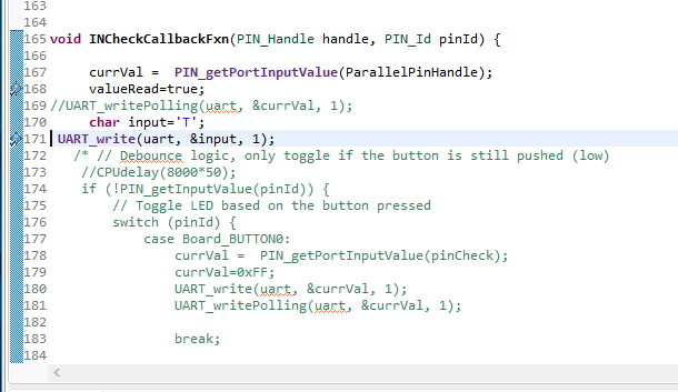

If I use interrupt call.

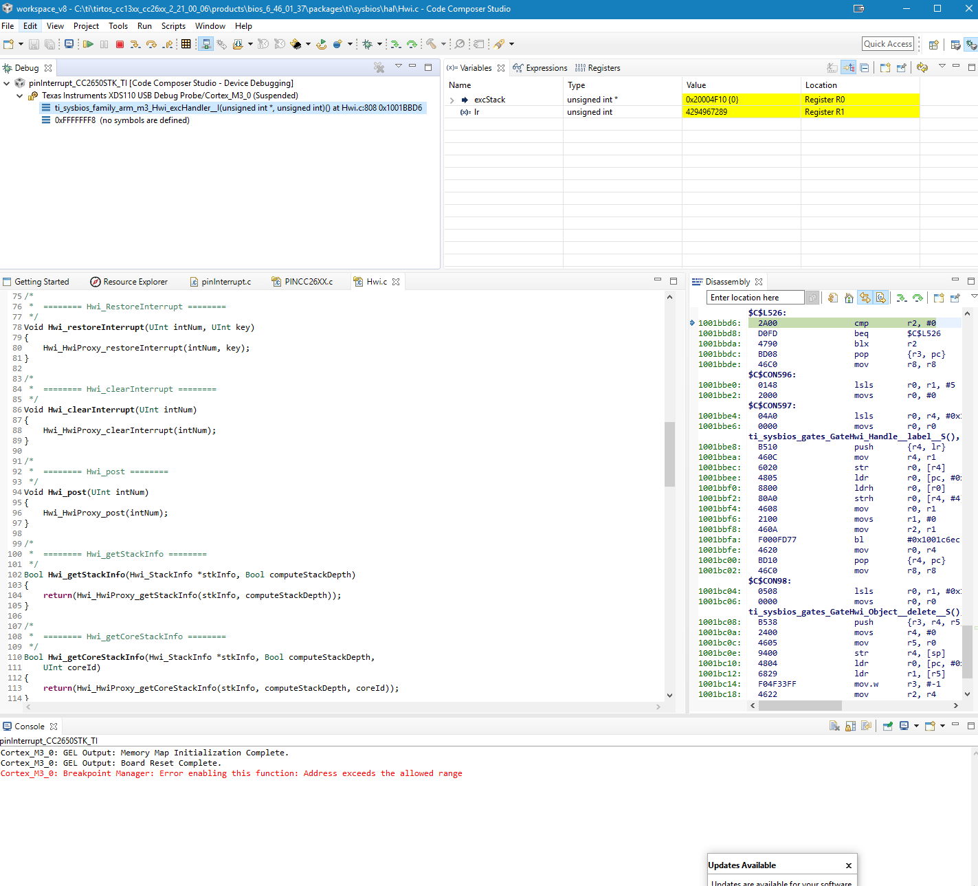

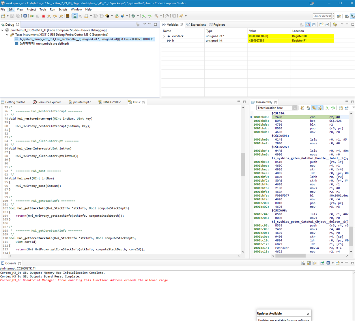

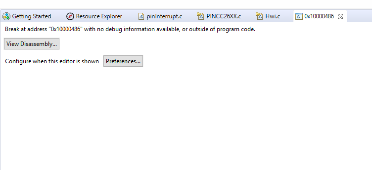

UART_writePolling doesnt output any data
and
UART_write output data once and program gets stuck.

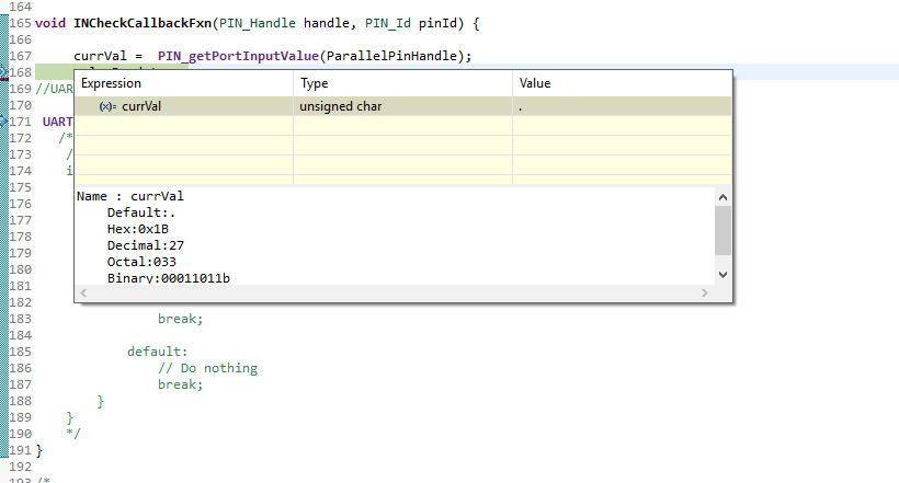

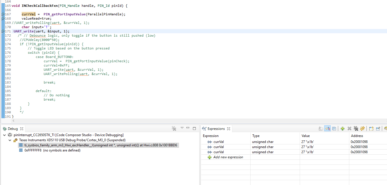

void buttonCallbackFxn(PIN_Handle handle, PIN_Id pinId) { currVal = PIN_getPortInputValue(ParallelPinHandle); valueRead=true; UART_writePolling(uart, &currVal, 1); // Does not outputs any data or UART_write(uart, &currVal, 1); //Programs gets stuck }
in main function
int main(void) { Task_Params taskParams; /* Call board init functions */ Board_initGeneral(); Board_initUART(); const char echoPrompt[] = "\fEchoing characters:\r\n"; /* Create a UART with data processing off. */ UART_Params_init(&uartParams); uartParams.writeDataMode = UART_DATA_BINARY; uartParams.readDataMode = UART_DATA_BINARY; uartParams.readReturnMode = UART_RETURN_FULL; uartParams.readEcho = UART_ECHO_OFF; uartParams.baudRate = 9600; uart = UART_open(Board_UART0, &uartParams); if (uart == NULL) { System_abort("Error opening the UART"); }

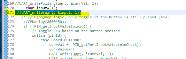

For me issue seems due to uart interrupt call inside interrupt routine.
I suggest you to use Desktop CCS and UARTecho example imported from CCS->Resource Explorer.
I tested the code below based on the documentation in the PIN.h documentation:
