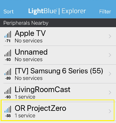

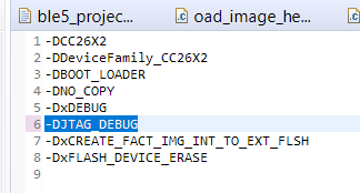

Hi,  I am currently working on Task 4, Bluetooth low energy 5 Fundamentals, in CCS project ble5_project_zero_cc26x2r1lp_app.
Per the tutorial's directions I have modified 2 variables  ( attDeviceName[], and advertData[]  ) , in project_zero.c
Please see the attached file.  The letters OR have been added to each of the strings.
Clean / build then proceeds smoothly.  The project is then flashed into the development board using the CCS debugger.  This also seems to go correctly.

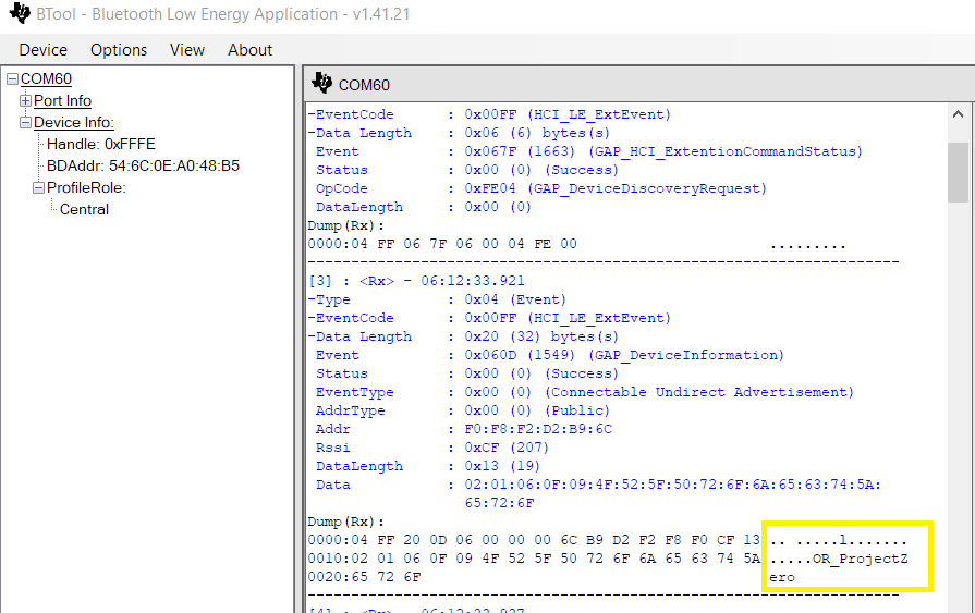

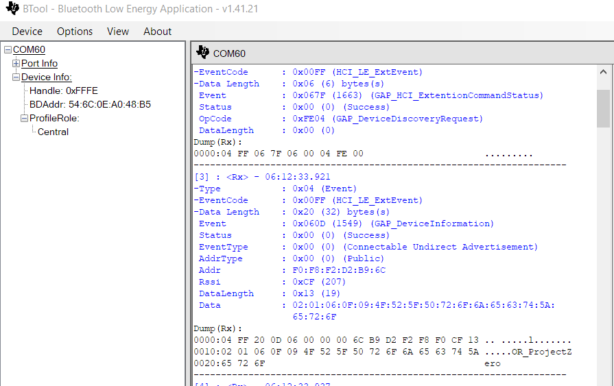

After cycling power on the development board, I launch BTool, scan, connect, find UUIDs, and then read the values.
The value of the Device Name still reads "Project Zero"
What am I missing here ?
Thank you
Roy
