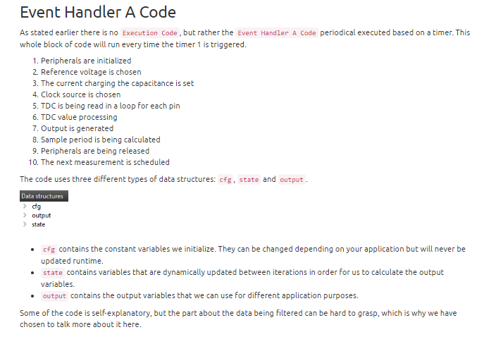

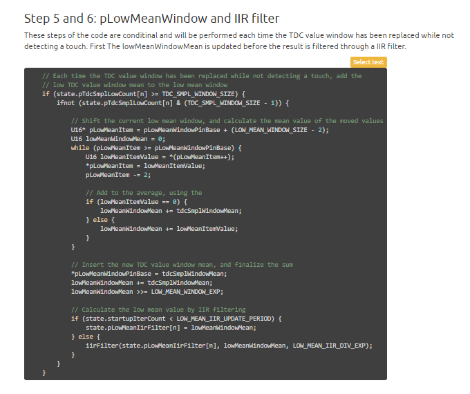

  • I have made screenshots of the part of the SLA that explain the code:
    Thank you for the explanation of the filter part of code.
