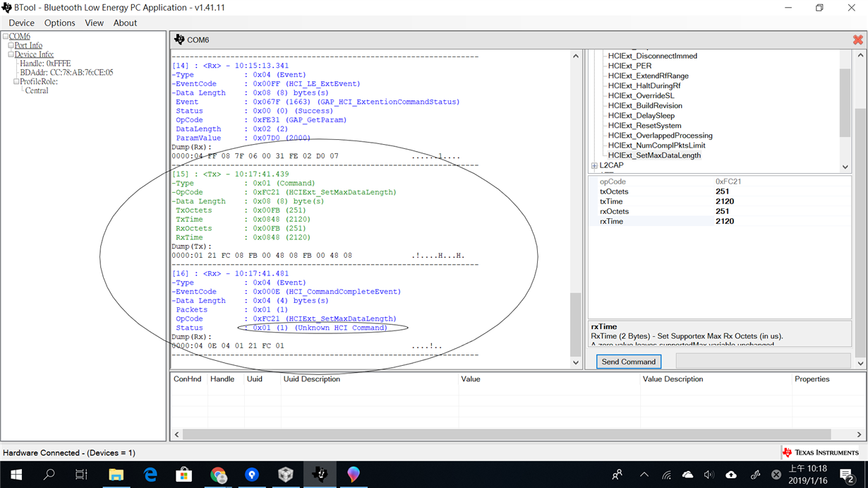

[109] : <Tx> - 03:40:42.808
-Type : 0x01 (Command)
-OpCode : 0xFC21 (HCIExt_SetMaxDataLength)
-Data Length : 0x08 (8) byte(s)
TxOctets : 0x0000 (0)
TxTime : 0x0000 (0)
RxOctets : 0x0000 (0)
RxTime : 0x0000 (0)
Dump(Tx):
0000:01 21 FC 08 00 00 00 00 00 00 00 00 .!..........
[110] : <Rx> - 03:40:42.848
-Type : 0x04 (Event)
-EventCode : 0x000E (HCI_CommandCompleteEvent)
-Data Length : 0x04 (4) bytes(s)
Packets : 0x01 (1)
Status : 0x01 (1) (Unknown HCI Command)
Dump(Rx):
0000:04 0E 04 01 21 FC 01 ....!..
Should I use the simple central to try this feature ?
or need anything change?

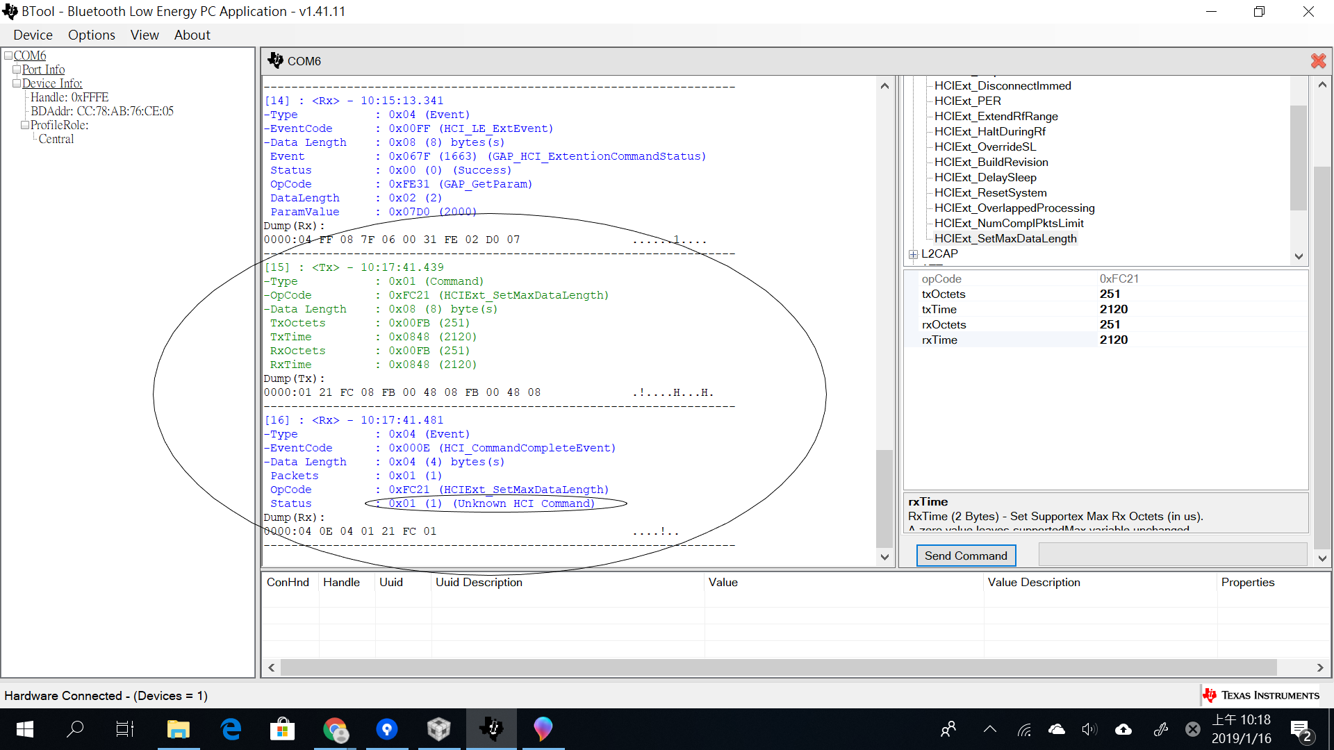

    When I tried to use host test with btool , it showed that HCIExt_SetMaxDataLength is unknown HCI command.
    I'm curious whether i need to do some modification of host_test.c .

    The parameters you want to change is normally set exclusively by the Controller to the maximum data length and duration allowed by this device. You don't need to change it especially when you are trying to 0.
    Also please be aware that this command can't be issued during a connection.
    Can you try to run the following command?
    LE Set Data Length Command (HCI_LE_SetDataLenCmd())
  • hi,
    i do really uncomment -DBLE_V42_FEATURES=EXT_DATA_LEN_CFG.
    do you mean this command , HCIExt_SetMaxDataLength? Because i can only find this command in the btool command list.
    and the result is as the picture below.

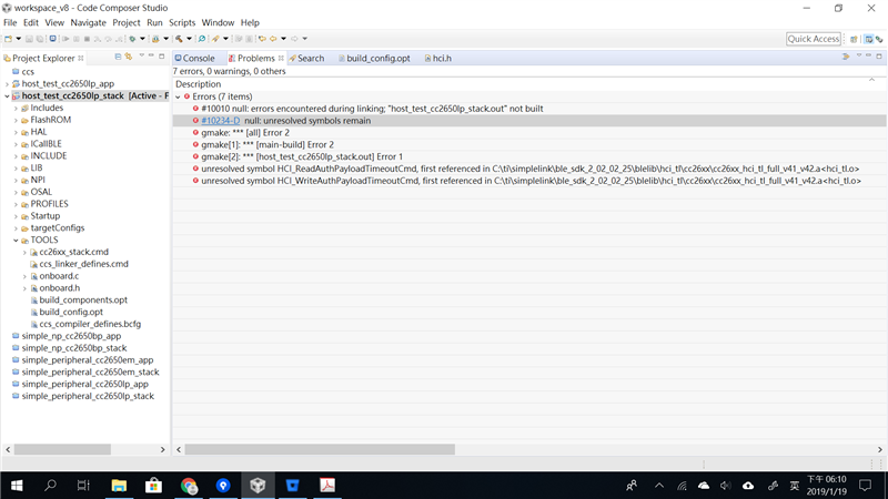

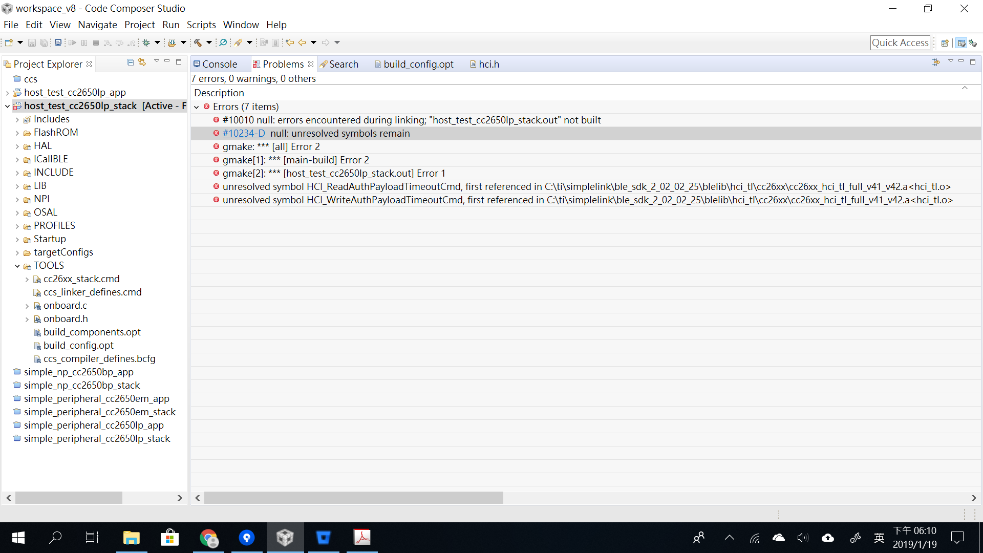

  • besides , when i uncomment   -DBLE_V42_FEATURES=EXT_DATA_LEN_CFG of host_test.stack ,
    the compile result will be error.
    y sdk :ble_sdk_2_02_02_25
    my xdctool :3.32.0.06 core
    my compiler : TI v18.1.4LTS
    thanks for help

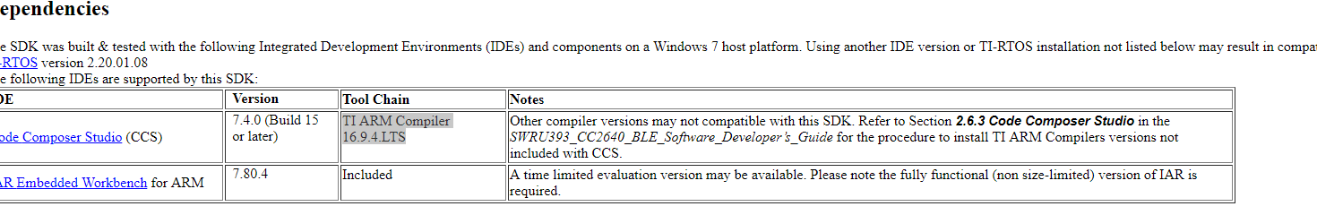

  • You need to use correct compiler version which is listed in the SDK release note.
    I have no problem building the host test when I uncomment -DBLE_V42_FEATURES=EXT_DATA_LEN_CFG.
