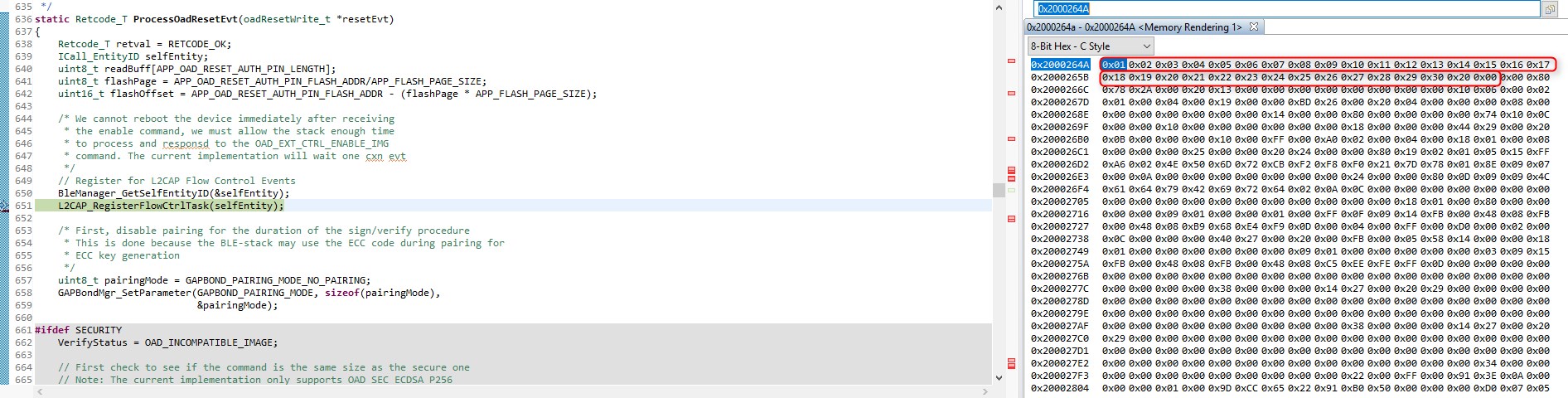

Arul Christopher

  • Hi Ammar,
    I did not make any modifications to oad_reset_service.c file (neither the resetCharVal nor ResetWriteAttrCB()). Instead i modified the application callback similar to function "user_enqueueCharDataMsg" in project_zero.c file of Project Zero. Here i am copying the characteristic value (pValue) to another memory before switching from stack task to application task.
    static void user_enqueueCharDataMsg( app_msg_types_t appMsgType,
                                        uint16_t connHandle,
                                        uint16_t serviceUUID, uint8_t paramID,
                                        uint8_t *pValue, uint16_t len )
     // Called in Stack's Task context, so can't do processing here.
     // Send message to application message queue about received data.
     uint16_t readLen = len; // How much data was written to the attribute
     // Allocate memory for the message.
     // Note: The pCharData message doesn't have to contain the data itself, as
     //       that's stored in a variable in the service implementation.
     //       However, to prevent data loss if a new value is received before the
     //       service's container is read out via the GetParameter API is called,
     //       we copy the characteristic's data now.
     app_msg_t *pMsg = ICall_malloc( sizeof(app_msg_t) + sizeof(char_data_t) +
                                     readLen );
     if (pMsg != NULL)
       pMsg->type = appMsgType;
       char_data_t *pCharData = (char_data_t *)pMsg->pdu;
       pCharData->svcUUID = serviceUUID; // Use 16-bit part of UUID.
       pCharData->paramID = paramID;
       // Copy data from service now.
       memcpy(pCharData->data, pValue, readLen);
       // Update pCharData with how much data we received.
       pCharData->dataLen = readLen;
       // Enqueue the message using pointer to queue node element.
       Queue_enqueue(hApplicationMsgQ, &pMsg->_elem);
     // Let application know there's a message.
     Event_post(syncEvent, PRZ_APP_MSG_EVT);
    The memory "pValue" and the Attribute Value "resetCharVal" seems to be different which i found during debugging and this is the reason why i did not make any changes to "resetCharVal".
    Now i see that the bytes are getting received properly without corruption.
