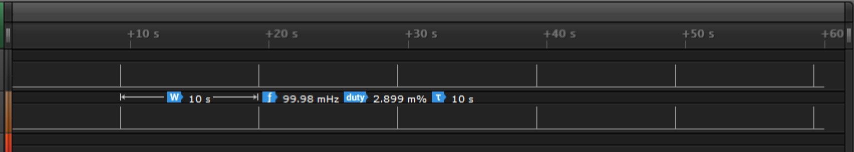

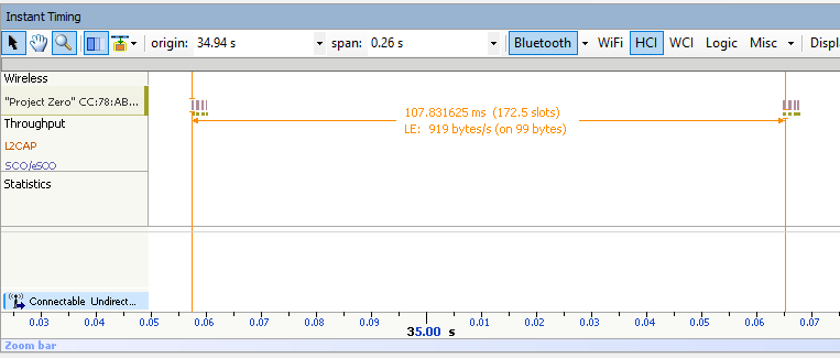

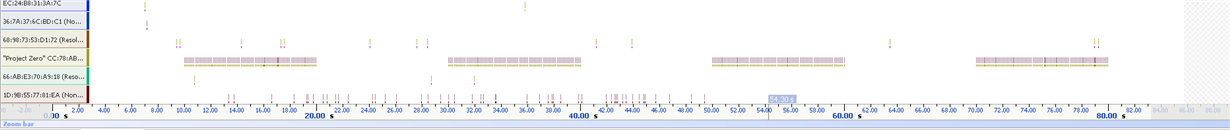

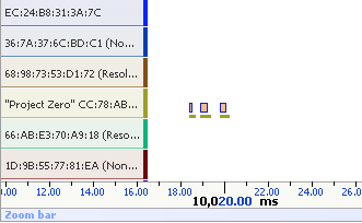

  • Dear Chaitanya,
    As in your example. I modified my DEFAULT_ADVERTISING_INTERVAL to 1600 (10s). Following the documentation from Debugging RF Output
    I mapped two different pins the RX and TX data. Viewing this info on a logic analyzer we can see that Adv events are happening every 10s.
    So this is the purpose of the DEFAULT_ADVERTISING_INTERVAL.
    If you wish to turn on advertisements for some period, then turn it off for some period. This will need to be done in your application. Take a look at this E2E post that shows how to do it. https://e2e.ti.com/support/wireless-connectivity/bluetooth/f/538/t/457269
    DEFAULT_ADVERTISING_INTERVAL is only meant to be the time between advertisements. Not between advertisement periods.
    I hope this helps!
    Kris

  • Chaitanya,
    May I ask how you are verifying this 10s long period? Can you redirect the RX and TX pins to the LEDs (pins 6 and 7) or if you have access to a logic analyzer then you can use like I did pins 26 and 27.
    I'm a bit confused still how you are achieving a 10s period with the modified simpleBLEPeripheral.c you provided. You are using the periodicClock to invert the initialAdvertEnable variable before it is set with GAPRole_SetParameter. Looks fine. Where I'm confused is that the periodicClock is being constructed with a 5s period. So if anything was to be happening. I would think that it would be advertising for 5 seconds only.
    Can you please identify to me how you are verifying the advertising period of 10s? From what I can tell you should have a 5 second period. What other changes have you made?
    Can you tell me the SDK that you are basing your work out of so that I can make sure I am comparing apples to apples as well please.
    Kris
    I am using ble_sdk_2_02_01_18 and ccs6.2 with tirtos_cc13xx_cc26xx_2_20_01_08 installed.
    Actually I am not receiving 10sec period nor 5sec periods. The advertising stops after some seconds and doesn't start again until reset.
    I am observing on BLEScanner app that board advertise for some random time and then never start again until reset.
    Instead it should advertise on and off with regular interval.

  • Chaitanya,
    This functionality can be achieved by following the thread I posted above.
    I've done the same and found these results.
