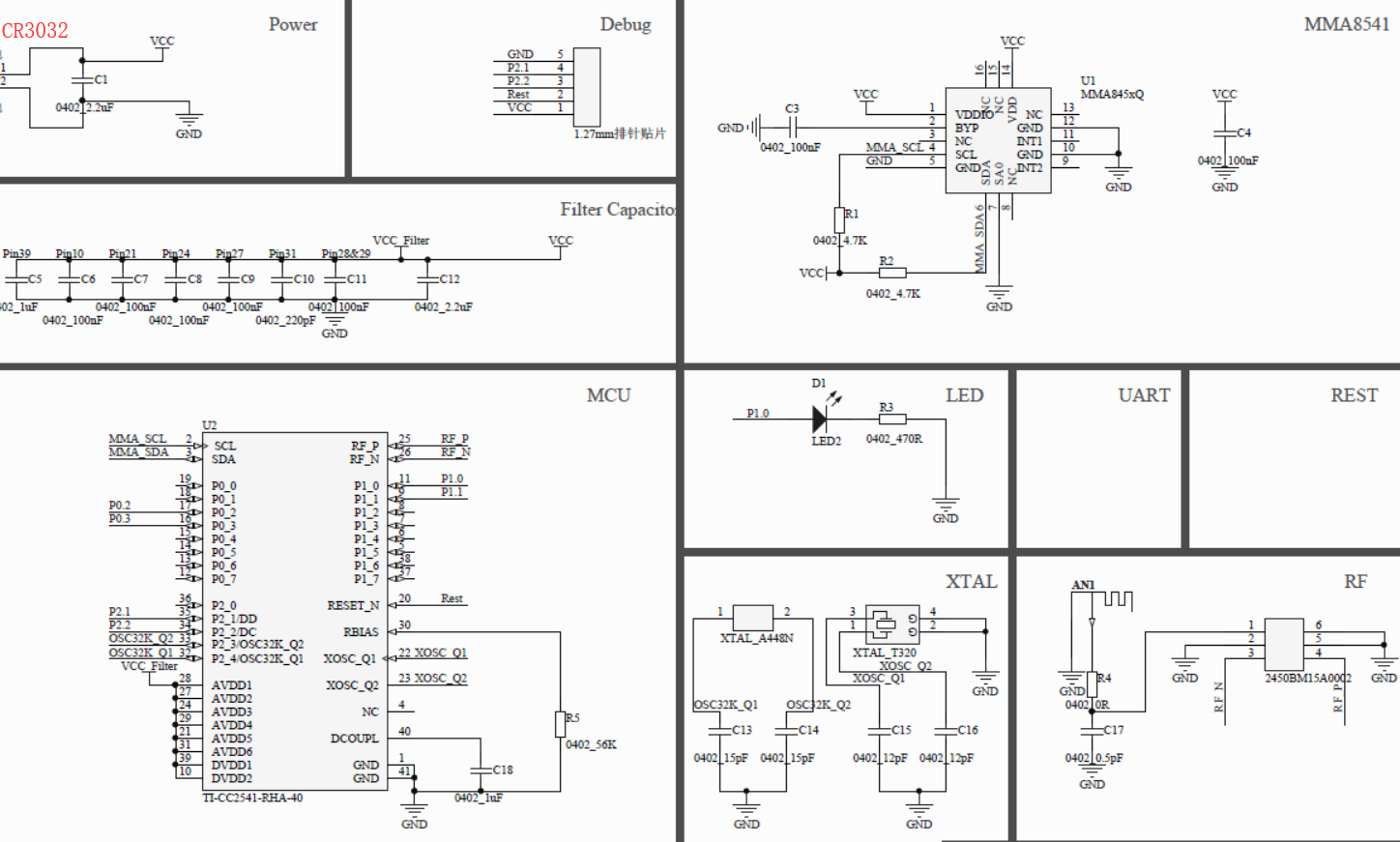

There are some problems abount power consumtion in my new application(setting cc2541 advertising period 1s  and get accleration by MMA8451 before advertising ,  update the advertise data right away),

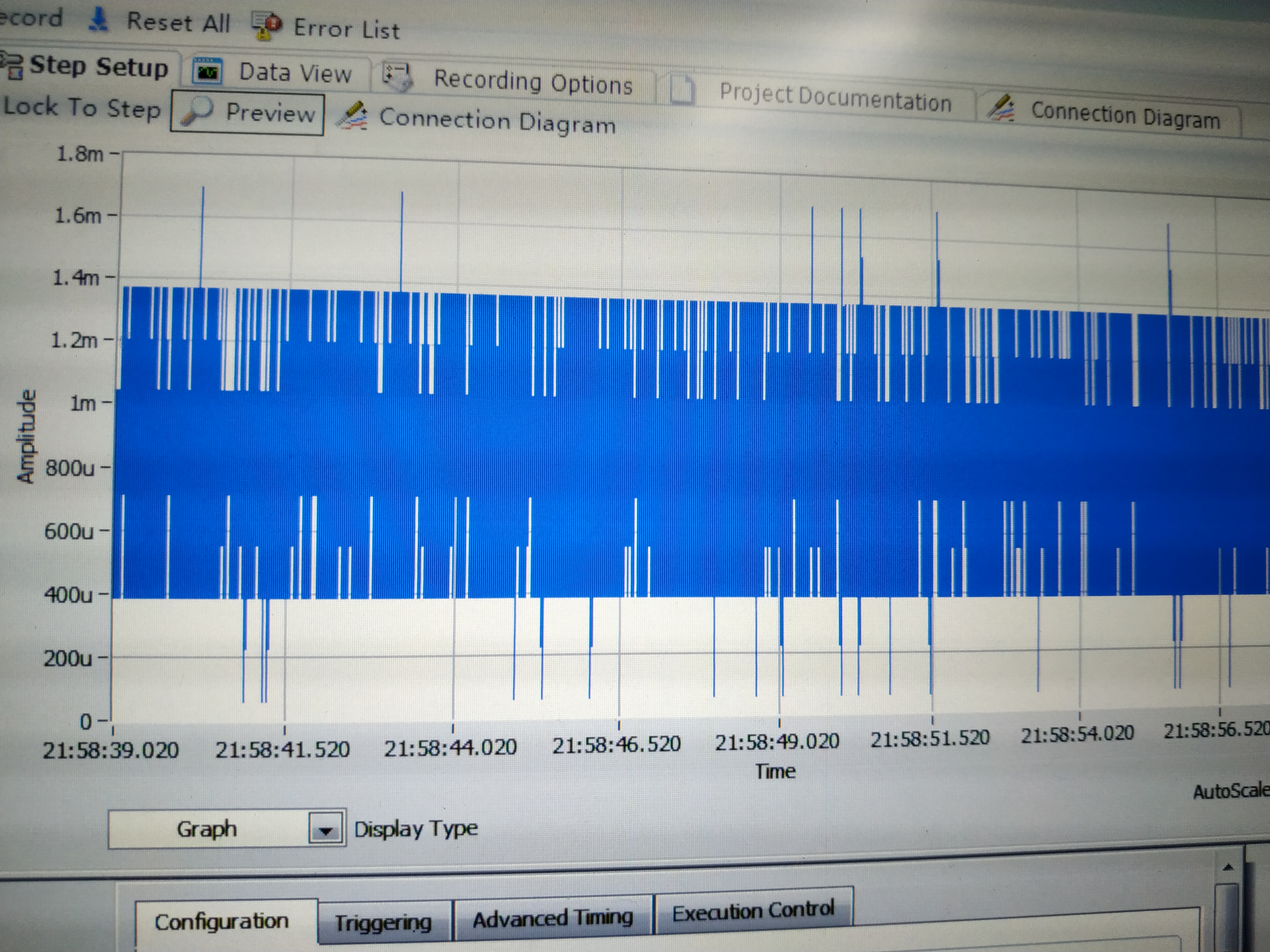

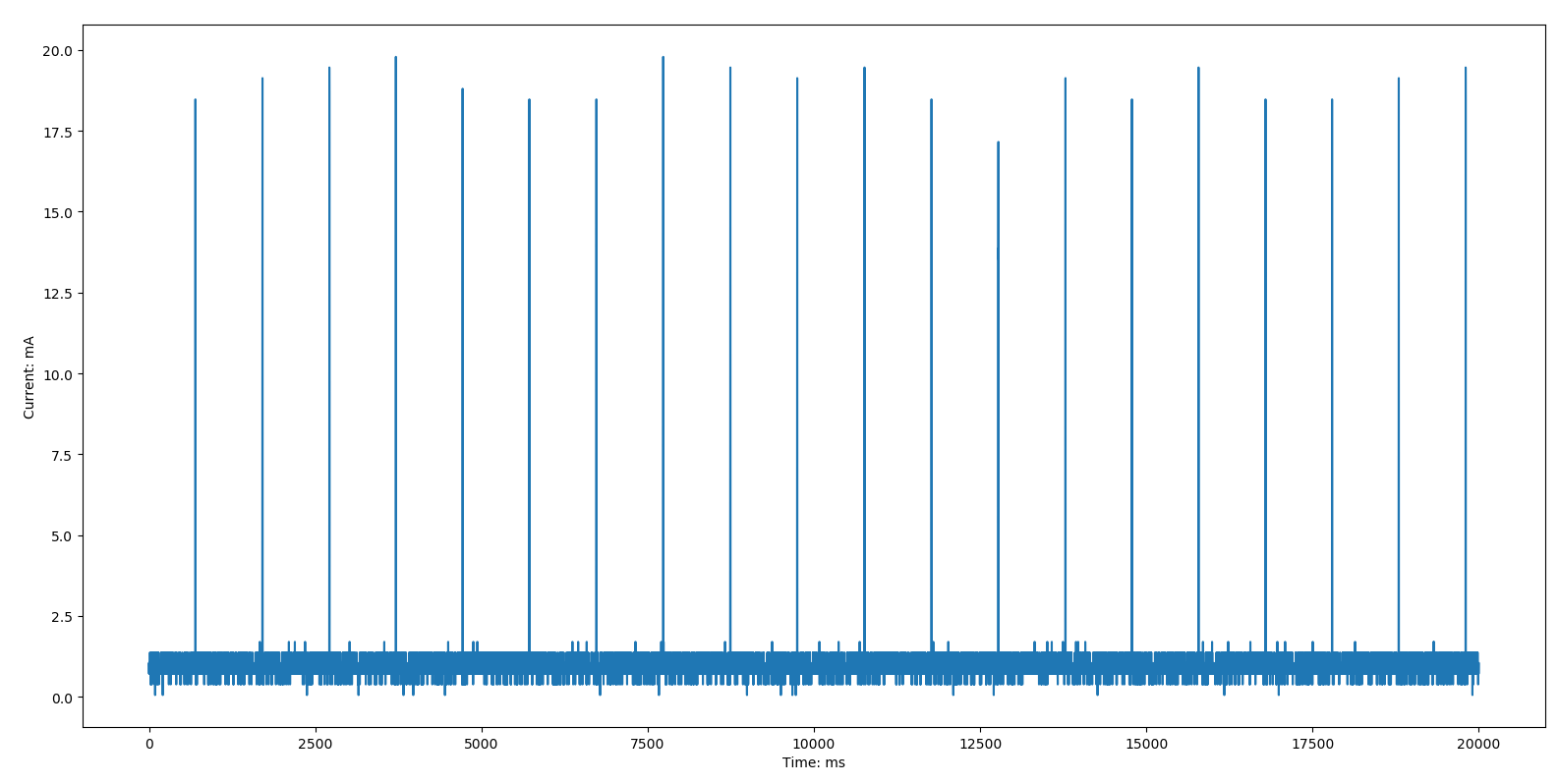

    It can work normally that get accleartion and advertise per second,but it takes more than 1.7mA during the cc2541 releax time (i nedd to under 1mA even  less)
it's my PCB design:
