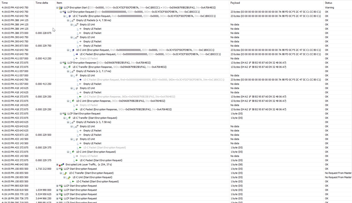

We have all our characteristics set with read and write authentication required setting, this means the moment we attempt a read using nRF Connect using the Smartphone, the pairing process begins. It seems the pairing process is successful and we even receive the corresponding callback from gapbondmgr passing a pairing success code for a pairing complete event.

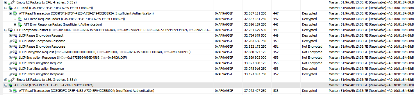

However, the issue we are observing is that we cannot get any data at all from any characteristic after the pairing process is completed and the link encryption is started. We observe our peripheral device is sending a "Start Encryption Request" every time as a result for a reading request coming from the master.
In the following trace, the Bluetooth sniffer shows that the initial encryption process sequence is apparently incomplete. However, we know that this part of the pairing is handled entirely by the stack.We have also verified there are no heap memory allocation issues when this happens. Here is a screenshot of the trace right after the one shown above after sharing the keys and the checks were successful:
The warning sign for the "LLCP Encryption Start" row says "Incomplete Sequence". After the pairing process is over, we can see the "Encrypted Link Layer Traffic" packets. Then, every time a read attempt is executed using the nRF Connect app on the Smartphone, we observe the event shown in this picture at the bottom "LLCP Start Encryption Request". One per reading attempt. The Bluetooth sniffer shows a "No Request From Master" warning when this happens.
Is it possible that the stack actually missed something during the initial encryption start process and that's why the Bluetooth sniffer is giving an "Incomplete Sequence" warning and hence we cannot read any characteristics data at all?

    Per the spec, during an LLCP Encryption start control procedure, the LLCP Start Encryption Response, which follows the Start Encryption Request will be encrypted. In order to decrypt this traffic, you can use the SC_HOST_DEBUG define described in the software users guide. This will enable code in the gapbondmgr to use link keys that are defined by the spec to be debug link keys. Ellisys traces will automatically see that the link keys are used and then proceed to decrypt all encrypted traffic.
    I would be interested to look at the rest of your ellisys trace though. You can attach the full file in the insert code attach files section below the comment box when typing a reply.

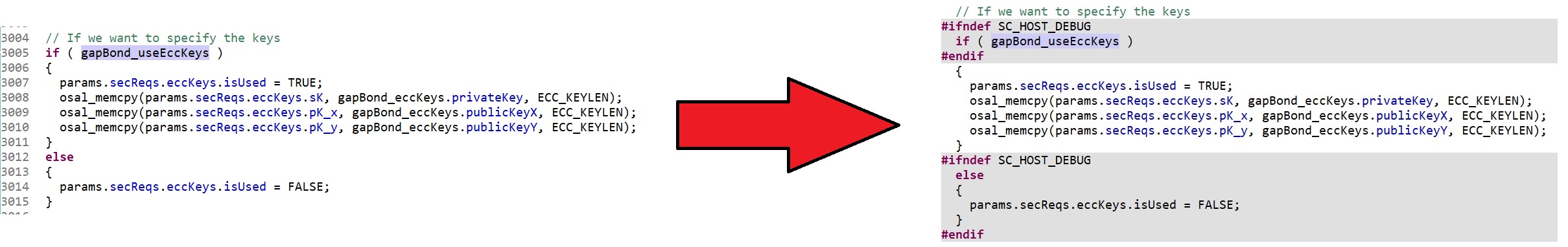

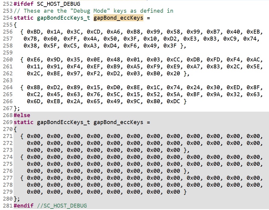

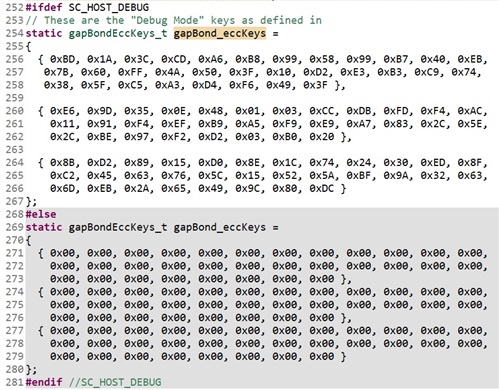

    Enabling the macro SC_HOST_DEBUG was not enough to use the debug keys.  When I tried again the connection after defining the SC_HOST_DEBUG macro I did not see the debug keys in the Bluetooth link. After checking the code, I observed that I had to edit gapbongmgr.c in order to actually pass the debug keys to the stack:
    Macro added to gapbondmgr.c (original code as is from Stack 2.2.2 on the left and modification on the right)

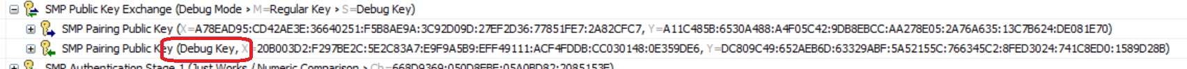

    Debug key observed in sniffer only after the change:
    As you mentioned, the Ellisys sniffer is now showing more information about the encryption process and when a reading request is executed from nRF connect app using the Android smartphone.

    I think that i know your problem. You have all your characteristics protected by GATT_PERMIT_AUTHEN_READ/WRITE but a just works pairing is not enough security to provide Authentication. Please view BLE Spec 4.2 Vol 3 Part H Section 2.3.5.1 Selecting Key Generation Method to look at what various levels of IO Cap between the initiator and the responder give an Authenticated session. That or change your characteristics to use GATT_PERMIT_ENCRYPT_READ/WRITE.
    When you try to read the characteristics that only allow authenticated read/writes, the device will respond with insufficient authentication and will request the other device have a higher level encryption hence why you always see LLCP Encryption Start control procedures being sent. This will all be resolved by either using GATT_PERMIT_ENCRYPT_READ/WRITE or making sure you set your IO Cap and MITM appropriately to permit an authenticated session.

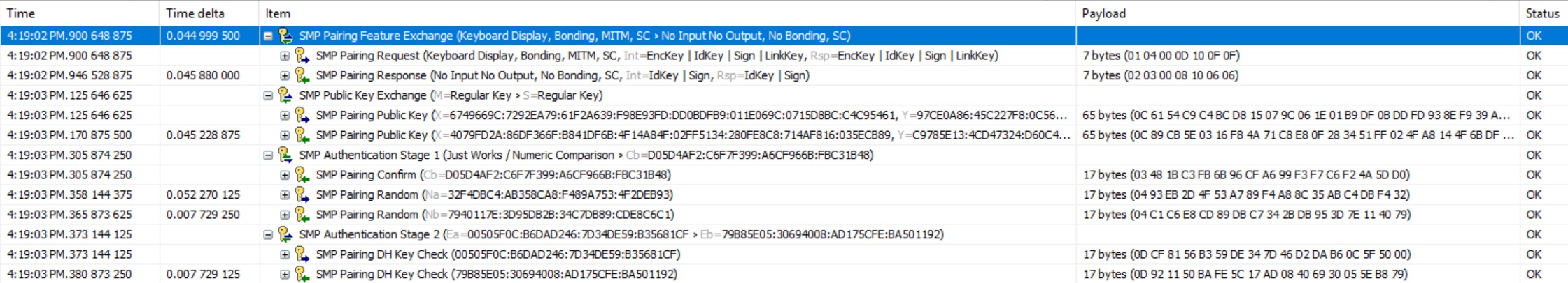

    In the log you've provided that ends with Cannot Read Data - Permit_Encrypt.zip" you have the following.
    The initiating device supports Keyboard Display, Bonding, MITM = true, and LESC is enabled.
    The responder supports No input no output, No bonding, MITM = false, and LESC is enabled.
    Therefore, a just works pairing session will occur.
    The devices successfully encrypt a session and begin service discovery.
    At some point, when an ATT read request packet is sent by the Samsung phone, an ATT error response packet is generated with insufficient authentication set.
    Because this is sent to the phone, the phone responds by trying to restart encryption.
    This leads me to suspect something is still wrong in your setup for your characteristics. Can you attach your code for one of the characteristics?

    In your gapbondmgr.c file, what have you set the GAPBOND_SECURE_CONNECTION to? i.e. GAPBOND_SECURE_CONNECTION_ONLY, GAPBOND_SECURE_CONNECTION etc?
  • My guess is that you have GAPBOND_SECURE_CONNECTION_ONLY set. According to the BLE Spec 5.0 Vol 3 Part C Section 10.2.4 when using Secure Connections Only Mode only security mode 1 level 4 (Authenticated LE Secure Connections pairing with encryption using a 128-
    bit strength encryption key) shall be used except for services that only require security mode 1 level 1 (No security (No authentication and no encryption).
    Since you are using just works and LE Secure Connection Only, you will not have an authenticated connection and therefore the stack will reject your request.
    If you change it to GAPBOND_SECURE_CONNECTIONS I believe you will be able to read it properly.
