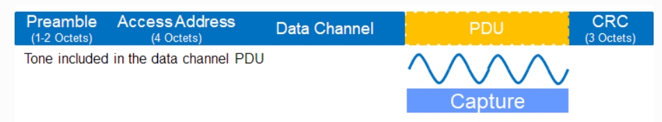

Data Collection Flow
Setup radio timer (RAT) channel to do capture when a AoA packet is received, All the code snippet in this section is included in AoA.c
How receiver know the AoA packet is received? by preamble?
What's the AoA packet receive process before PDU is received? add delay?
    With a packet ID, please review the API transmitterInitAdvData in AoA.c
    When the receiver gets AoA packets, the RF core will trigger an event that will lead to start the antenna switching (all of these are done prior to I/Q sampling). Then, the RF core will start sampling the I/Q data at the beginning of the AoA tone (PDU) and the sampled data will be stored at the RF RAM.
    For more information, please review this AoA SLA dev.ti.com/.../ble_aoa.html
    Hopefully this helps.
