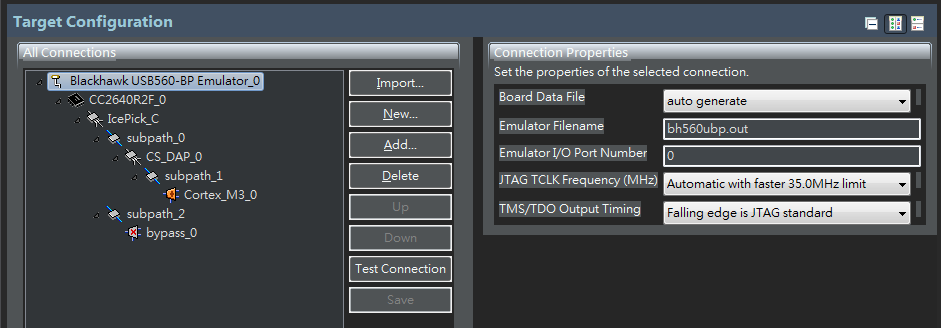

Hello!
I am using the USB-560BP debugger on the CC2640R2F.
Then I got  "SC_ERR_HUNG_COMMAND" error. How to solve the issue?
CCS 8.2.0
Pin connect :
USB-560BP CC2640R2F
TMS TMS
TRST RESET
TDI TDI
GND GND
TVD VCC
TDO TDO
TCK_RET RTCK
TCK
TCLK
EMU0
EMU1
Target configuration
log:

An error occurred while hard opening the controller.
-----[An error has occurred and this utility has aborted]--------------------
This error is generated by TI's USCIF driver or utilities.
The value is '-342' (0xfffffeaa).
The title is 'SC_ERR_HUNG_COMMAND'.
The explanation is:
Failure due to the controller command-finish taking too long.
