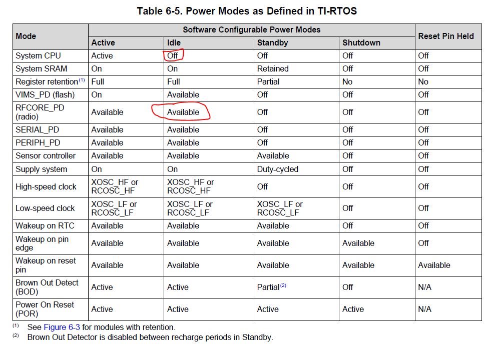

  • Hi YiKai Chen,
    Thanks for the quick reply. I found a table in TRM, it shows as below:
    Here it mentioned as, when the device is in idle mode: RFCORE_PD (radio) is Available. And if any mobile device is already in a connection (before ble goes into idle), is there any possibility of writing a char value and detecting in the ble application and that value can be used as trigger for wake up. Please correct me if i am wrong.

  • Table 6.2 in describes in detail what is on the the various modes.
    Could you elaborate a bit why you are looking for the policy file?
    Have you looked into this section in the board file to see if that could do what you want?:

    Not sure what exactly you are looking for. Could you elaborate? The power modes when using BLE is set by TI-RTOS and the BLE stack and they are set to use as little power as possible at all times. If you look in 6.3 in www.ti.com/.../swra478d.pdf you will see hoe the power profile using BLE looks like.
