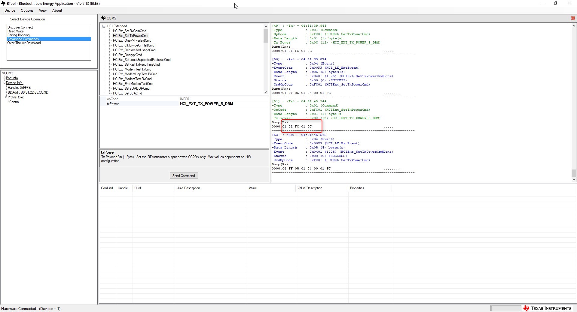

I using lauchpad with Host test example application for DTM.  I want to set the TX power command to 5dBm.
I used HCI_EXT_SetTxPowerCmd(HCI_EXT_TX_POWER_5_DBM) to set to 5dBm in host_test_app.c file after ICall_registerApp in HostTestApp_init function.
But during EMC test the TX power level was showing 0dBm only.
I have modified the code to have the DEFAULT_TX_POWER as 12(5dBm) in ble_user_config.c file along with the above changes and also set the TX power level using Btool as given below. But there is no change in power level. I sthere any command to read the TX power level in Btool.

  • Hi Frederik K,
    we where measuring TX power level inside our EMC chamber and found that we are only sending with 0dBm.
    As measurement in our EMC chamber is quite limited we are now trying to see a difference in the current consumption of the CC2640R2  between 0dbM TX Power Level and +5 dBm TX Power Level.
    For both cases 0dBm as well +5bBm  we see the same current consumption of ~7mA when setting the device to "HCI_LE_Transmitter Test"
    Changes in code as described above do not result in a different current consumption!
    The HCI commando  "HCI_EXT_TX_POWER_5_DBM"  do as well not lead to a change in power consumption!
    HCI command flow is like this:
    Reset all:                                                          01030C00                                  Answer: 04 0E 06 01 1F 20 00 00 00
    (Optional) TX Power Level increase           01 01 FC 01 0C                         Answer: 04 FF 05 01 04 00 01 FC
    HCI_LE_Transmitter Test                              011E2003000A00                    Answer: 04 0E 04 01 1E 20 00
    HW we use is a SaBLE-xR2 BLE module (CC2640R2) .
