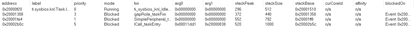

Hello!
I set up a job with Characteristic 4 Value according to e2e.ti.com/.../764078
And now I can send more bytes, but only once or a little more.
Please help with the following points:
1) I assumed that the Simple_profile project uses the AUTOHEAPSIZE define, i.e. there is no need to set HEAPMGR_SIZE manually. I'm right?
2) According to the recommendations, I tried to track HEAPMGR_SIZE after changing MAX_PDU_SIZE from 69 to 255, but the result is the same - 5163 bytes. In my opinion, he had to change, because AUTOHEAPSIZE mode is used. Or should not?
3) I tried to increase SBP_TASK_STACK_SIZE even 1500 (now SIMPLEPROFILE_CHAR4_LEN == 251) - to no avail ... I think I need to increase SBP_TASK_STACK_SIZE but only slightly more than 250 bytes according to the new SIMPLEPROFILE_CHAR4_LEN. I'm right?
4) After sending 251 bytes or several smaller packages, the program no longer sends packets and issues HAL_ASSERT_CAUSE_ICALL_TIMEOUT. How to fix it?
5) I can not get the parameters of the Tasks STACK in debug mode using TI-RTOS. Gives the message: Target memory read failed at address: 0x20002ccc, length: 76
Something with an overflowing stack? How to fix it?
6) Can BTool / LAUNCHXL-CC2640R2 with the host_test project receive and output to Btool log 251 byte packets? I think so, because in preprocessor define MAX_PDU_SIZE = 255. I'm right?
    It may be helpful for you to take a look at the .map file after building your project to get an idea of how things are being allocated and what may need more memory. Additionally, you can use the Memory Allocation tool to see an overview of your memory usage. Again, take a look at the debugger's guide for more information.
    You can use the ROV (explained in the user's guide) to take a look at individual task usage. If you have memory issues, then this is likely the cause.

  • Have you tried debugging to see the usage of your task's stack to check for a memory overflow? I believe that is what may be causing this issue.
  • Hello Ammar!
    I found stack size of simple profile task when no ASSER accurs when I can try to send via SimpleProfile_SetParameter()  a 200 byte nonifications every 10ms. But now none of the packages are transferred. Stacks are not crowded (see attached screenshot). What could be in this case? Maybe I need to set smaller values of TX and RX buffers? If so, how to do it right?
  • Ammar, will ypu able to check my map file? I don't see any problem in it...
    Thank you very much in advance !ble_simple_peripheral_cc2640r2lp_app_FlashROM_StackLibrary.zip
  • Can you share the code changes you've made? It's difficult to assist without being able to reproduce this issue on my end. Additionally, it may help to see sniffer logs (this is different than the output of the host test console).
    As for the stack usage, it looks fine, as does the map file.
  • Ammar, I made some changes in code (delete large arrays) and now all works. Thanks for your help!
    If you can help with another my trouble - i'll be wery glad : e2e.ti.com/.../2856381
