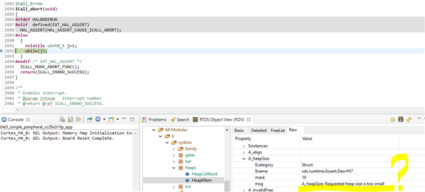

I started a project from the example (ble5_simple_peripheral_cc26x2r1lp_app), it works well and I can debug. But as soon as I add an extra task, I can debug once, after which the project will not run anymore. without the debug mode, the program always runs.
I tried several things (ICall max entities and tasks, heap size) but without success.
when I debug, I arrive regularly in the while(j) of ICall_abort() function
you will find the project as an attachment.

    But when I add all my code in the second task, the singlePeripheral task does not boot anymore. it does not pass the function
    (in SimplePeripheral_init) :
     // Create an RTOS queue for message from profile to be sent to app.
    appMsgQueueHandle = Util_constructQueue(&appMsgQueue);
    I feel that the size of the heap is not enough to work in debug. Is it possible that it turns when there is no debug. and that poses problem when we want to debug?

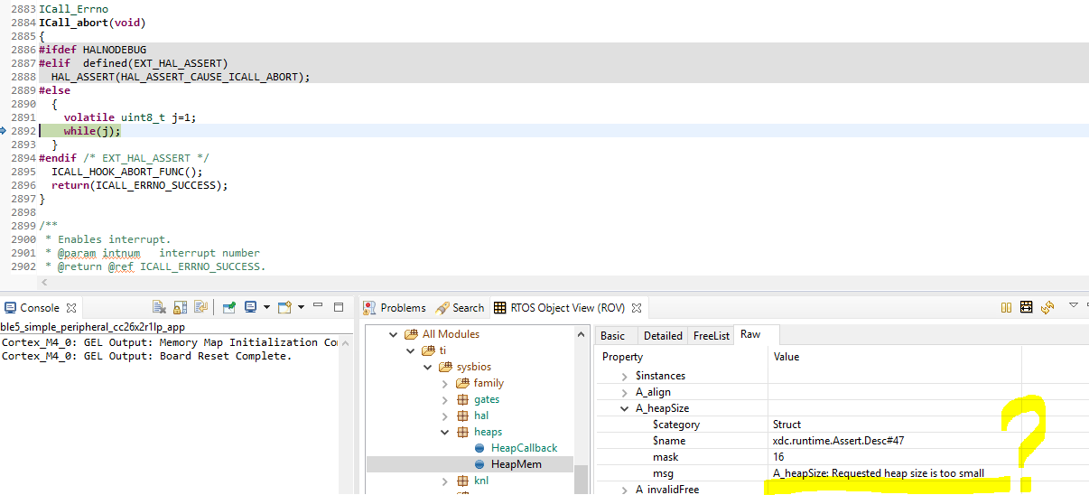

    when i'm in debug mode and i'm putting the program on pause i get this:
    I have HEAPMGR_CONFIG = 0x80 // osal Heap manager, with auto-size
    and I can see in Expressions watch HEAPMGR_SIZE 63284, this value seems very hight.. what is the max value?

    It would appear that your added code as added a memory leak to the application. I would take a look at the Debugging section of the User's Guide to understand how to best debug a Heap/Memory issue in your BLE application. dev.ti.com/.../ble-index.html
    Assuming correct memory management, auto-size heap should be plenty of space. Looking at the comments in the ble_release.cfg we can see that using 0x80 for the osal Heap manager as you have mentioned states "with auto-size: The remaining RAM (not used by the system) will be fully assigned to the Heap"
