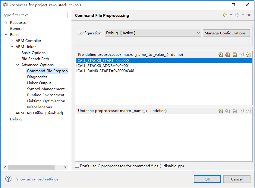

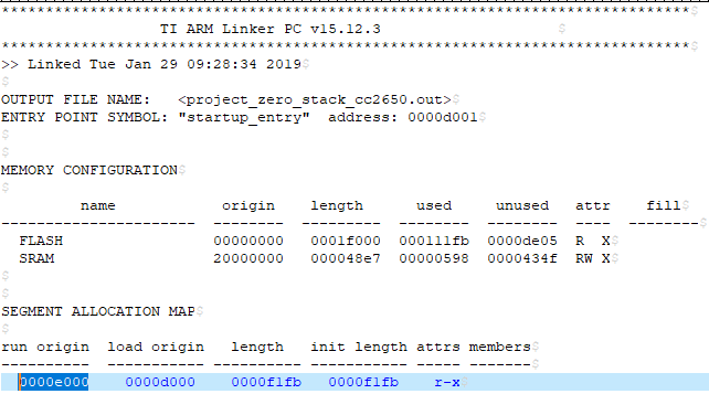

when I set OSAL_SNV = 1, stack run origin address = 0x0000e000, It works fine.

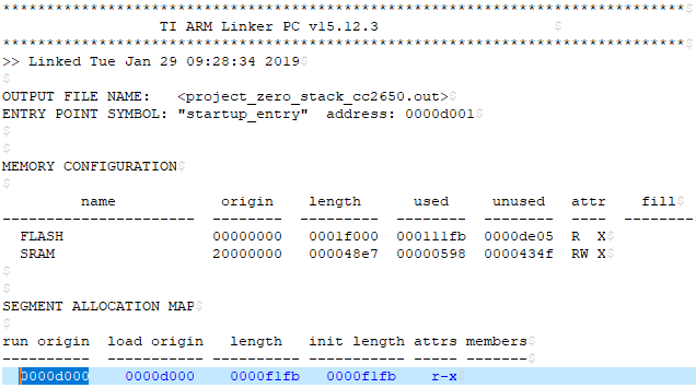

but when I set set OSAL_SNV = 2, stack run origin address = 0x0000d000,  It break.  Download  the firmware by RF Flash Programmmer 2 1.7.5,
How to avoid this?

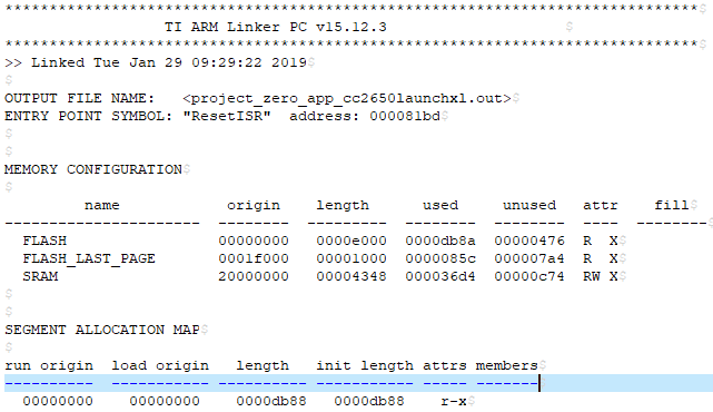

I modified stack and app boundary address ,  for example, ICALL_STACK0_START=0xe000  -->  ICALL_STACK0_START = 0x10000,   ICALL_STACK0_ADDR = 0x0e001 -->  ICALL_STACK0_ADDR = 0x10001,  when I download the firmware, It the same result  as the previous mentioned.
How to adjust stack and app flash space ?
