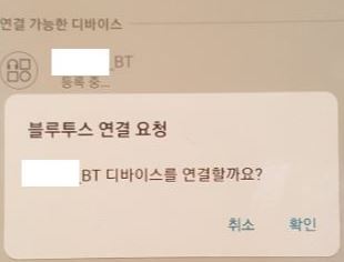

Project is underway with cc2564b.
After connecting with CC2564b and smartphone, the Bluetooth connection window(Put the pin code) from the smartphone.
the connection window will pop up the first time.
I want to get rid of the first one(the Bluetooth connection window(Put the pin code))
Ask for help.

    we use pmPairableMode_EnableSecureSimplePairing options when pairing the device.
    My reference product does not display a popup confirmation window when you first pair the device.
  • So, you are pairing from a smart phone to a device having CC2564B right? Did, you try setting the IO capability to, "icNoInputNoOutput". this would result in "just works".
  • Hi, Nagalla
     I pairing from a  my cc2564b bluetooth device to smartphone using HIDConnectRemoteHost functions in HID profiles.
    I'v used the IO capability as below,but not solved the problems.
    #define DEFAULT_IO_CAPABILITY (icNoInputNoOutput) /* Denotes the */

    Even if I use all the options below, a popup window will appear when I connect the Bluetooth.
    #define DEFAULT_IO_CAPABILITY (icNoInputNoOutput) / * Denotes the * /
    #define DEFAULT_MITM_PROTECTION (TRUE) / * Denotes the * /
    thank you.
  • Hi Nagalla,
    Ask again.
    1. Connect device and smartphone Bluetooth for the first time.
    2. The confirmation pop-up window pops up at first.
    3. Save Bluetooth LinkKeyInfo information to MCU.
    4. When you reconnect your smartphone and Bluetooth later,
    Load stored LinkKeyInfo.
    5. Do not pop-up windows at this time.
    Thank you.

    scenario
    1. Set on
    2. Connect device BT on your smartphone.
    3. Set power off (save link key information at this time)
    4. Set power on (link key information recovery at this time)
    5. Reconnect with your smartphone with the HIDConnectRemoteHost function.
    6. At this time, a popup window appears.
    We want to make the popup window disappear.
    please check.cc2564_dump.zip
