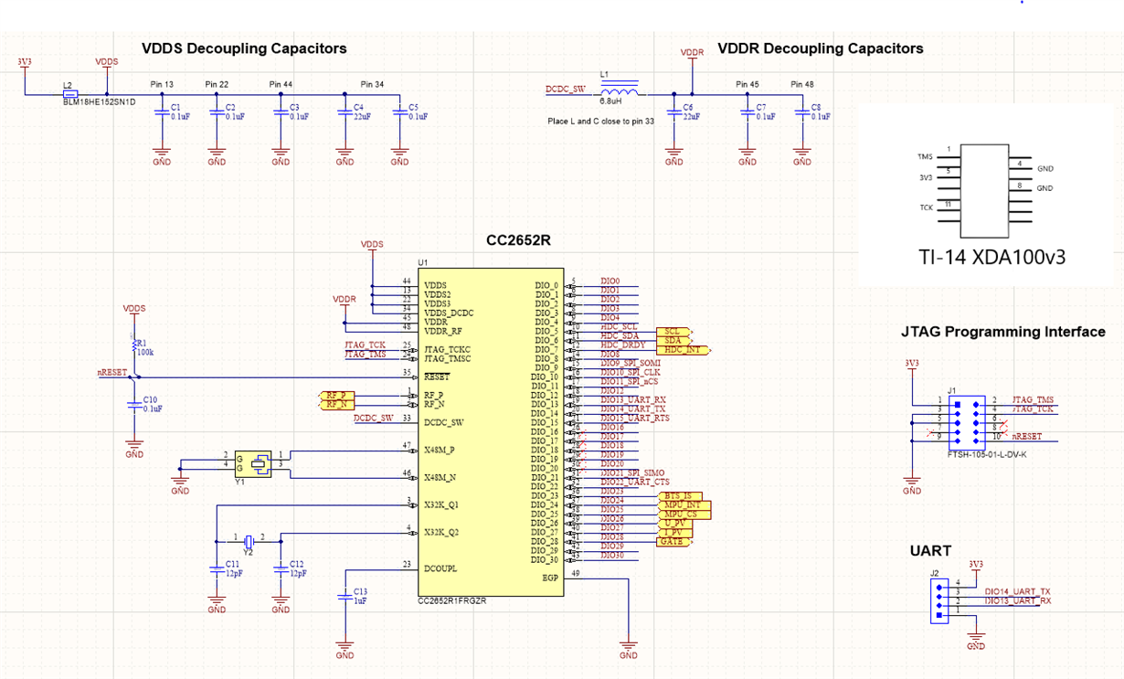

I have a custom board as shown in the picture below and try to flash it with an XDS100v3 (embest).
As explained in the this thread, the 14-pin JTAG-connector has no nRST pin:
http://e2e.ti.com/support/wireless-connectivity/bluetooth/f/538/p/590762/2225895
Connecting my board's reset pin (nRESET) to T_SRTST_N on the XDS100 is also not working. (see the XDS100 schematics on second picture)
In CCS, I get this error:
SC_ERR_SCAN_POLL_BUSY
Flash Programmer 2 could not detect the target device.
With the oscilloscope I can't see any signal on the T_SRTST_N and T_TRST_N lines.
I tried this with 3 different boards.
How to connect XDS100v3 via TI-14 to CC26xx devices? Has anybody done this successfully?
Thanks for your help!
