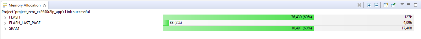

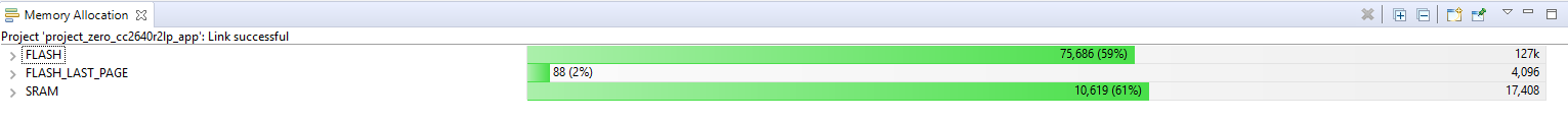

    For Question 2: The question is too broad to answer. There are many different settings and configurations that will affect the RAM/FLASH usage. Therefore, it is best for you to compare the use case and configuration you make use of to identify this change. I can say that for project_zero BLE 4.2 increased by about 400 bytes from 2.30 -> 2.40. It is unlikely that this will make or break your project.
    Again, this is the out of the box project zero. So if that doesn't match your use case. I would suggest simply building the project and looking at the flash usage for your use case.
