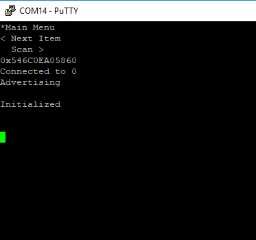

  • Hi Kris,
    Thanks for the quick reply and I found it.
    Now, I have a different problem.
    I successfully built the project, downloaded it to the LaunchPad and ran it.
    I even could use an Ipad to connect to the board by pairing.
    But, the Menu screen in the serial terminal screen (Putty for me) did not match what the following link described:
    See attached my screen shot.
    Also, I could not enter anything. In other words, the Right Button did not work.
    Per the description from the link, 'the right button is used to select one of the available options. '.
    Don't know why.
