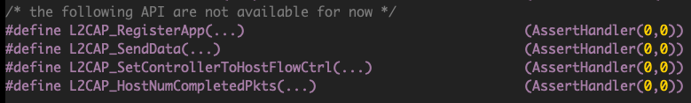

while L2CAP CoC offer some support since SDK 2.30, any useful support is still missing in 2.40.
I'm succesfully using lower level APIs like `L2CAP_SendSDU` but the whole purpose of L2CAP CoC is defeated when APIs like `L2CAP_SendData` are not available.
There is no streaming support without those functions. What are your plans to support this?
Or am I missing something vital?
    L2CAP_SendSDU is the higher level API. An SDU is a higher level application packet that may be (internally) fragmented by the L2CAP layer into multiple PDUs based on the PDU size negotiated with the peer. In summary, at the L2CAP layer an SDU is segmented into multiple PDUs. Once the SDU is segmented, the L2CAP_SendData API is used to achieve sending the PDUs over the Link Layer. So in summary, our stack is performing segmentation and reassembly. Is there a reason you would need to access the sending of individual PDUs from your application?

  • Hi Oliver,
    Your understanding is correct. However, you just have the API names don't correlate exactly to your understanding. L2CAP_SendData is used internally by the BLE-Stack to send data over a fixed channel. This is why it is not a public API and used only internally by the stack. For example ATT and SM will use this API internally for fixed channel traffic.
    >> I mean I expected that I do not need to chunk up my data and reassemble it
    This is correct. And for connection oriented channels, L2CAP_SendSDU is the API you are looking for.
    It will take one SDU (which with the TI BLE-Stack can be up to 512 octets) and it will fragment/segment it into a number of link layer PDUs which can range from 27 to 251. At an application level you should only be presented with complete 512B SDUs.
    Have you negotiated an MTU of 512 for your connection oriented channel? Then you should be able to send this in a single API call from app to stack and the stack should segment the SDU for you.
    In summary: L2CAP_SendData is internal for fixed channel. L2CAP_SendSDU is the correct API for high level usage and should hande segmentation/reassembly for you.
