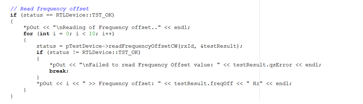

  • If you open SmartRF Studio and go to the Tools menu in the upper right corner, click on the "SmartRF Test Environment". In the RTlib it should be an example on how to measure frequency offset.
    The question is how to use this information. For an application using prop commands the offset could calculated in to the frequency given to the CMD_FS. In the BLE stack the parameters to this command is more hidden. You can as an a different option modify the load cap array. If you have a table given for the xtal/ board you are using that setting the array one value up or down equals x Hz you can look up in this table and see what you have to set the array to in the CCFG area.
  • What is needed here is that how can we read the Frequency offset from the Golden Unit in RX mode, when it is receiving the signal from DUT in TX mode. The code in Radio test tool library just gives a call to a function but the body of that function is not exposed, as to how and from where the value is read and how it is interpreted.
    Kindly, help in marking the precise register or function which can be used to know this frequency offset value from application code on CC2640R2F.
  • The function gives the frequency in Hz.
    It's still not clear why this library can't be used (we use this for production testing of the launchpads) or why this testing is required. BLE has a large frequency tolerance and it's unclear what you want to gain by doing this test.

  • Given that a CMD_RX_TEST command is issued and a CW is sent from the golden unit:
    Set
    HWREG(0x40045220) = 0x0200;
    Read:
    FIFE= HWREG(0x40045250);
    The offset in Hz:
    Offset = ((FIFE/32) * deviation)
    Note that this will only work with the CMD_RX_TEST command. It's not possible to read out the offset receiving BLE packets.
