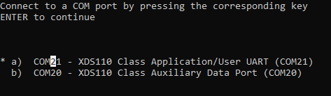

I have followed the README.html instructions for the rtls_agent demo included in the simplelink_cc2640r2_sdk_2_40_00_32. I am running Python3.7.2 on Windows 10 and have made sure to install the below Python modules as directed by the requirements.txt file. I have (3) LAUNCHXL-CC26X2R1 boards programmed to Passive, Master, and Slave images for the RTLS demo.
When I run the websocket_server program, either from the executable, or from Python in a Command Prompt, I see the COM ports of my nodes, select the Master and Passive ports, press ENTER to 'Continue' and then the program crashes with the below output:
(.venv) C:\ti\simplelink_cc2640r2_sdk_2_40_00_32\tools\blestack\rtls_agent>python websocket_server.py

    The error reporting is unfortunately a bit bad here. This error generated when the device on the com port did not respond to the IDENTIFY command over the serial port. (it's the capabilities object that doesn't exist and has no attribute 'items')
    This could be because you didn't choose the 'Application/User' com ports, because the launchpads are not properly flashed with the correct firmware, or perhaps you were unlucky and tried to open the slave's serial port (it does not support the uNPI serial interface).
    I'd perhaps recommend trying just 1 by 1 com port to try to identify which of the devices/com ports work, if any.
    If you want to get a bit nitty gritty you could also launch the websocket_server script/exe with --debuglog as a command line argument. This will output a text file with more low level information as well.

    I connected only the MASTER node and attempted to connect its Application/User UART COM21 port, as shown below:
    The program said "Connecting to 1 node and identifying' before crashing the same way. Below is the debuglog output which highlights line 174 of code in websocket_server.py:
    • 174 : logging.info(node.identifier)
    Summary - I ruled out (1) not selecting 'Application/User' COM ports (unless there is an issue that it's a device running in Windows 10 on my Mac using Parallels) and (2) being unlucky and trying to open the slave's serial port. So that only leaves (3) not properly flashing the launchpad with the correct firmware. On that front, I imported and built the below project:
