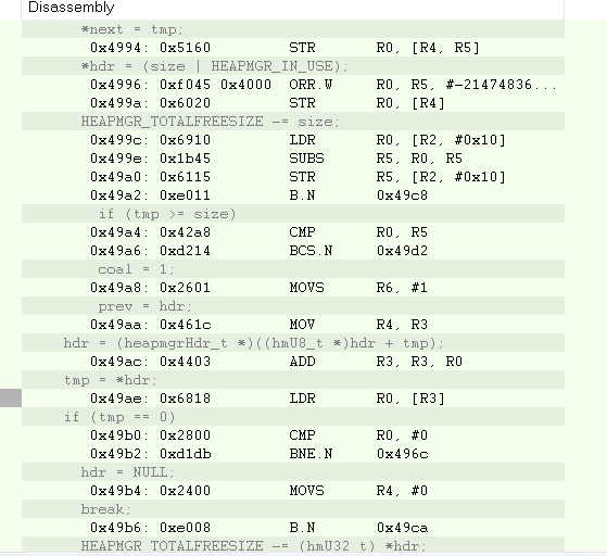

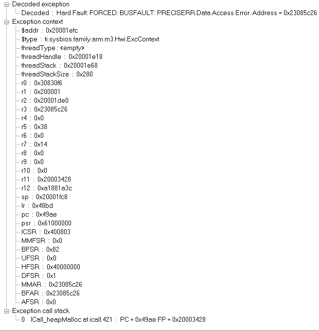

    Based on the information you have provided, it seems that the device has encountered a exception because it has tried to access and address which is outside of the SRAM region of the CC2640R2. (0x23085C26 >> 0x20005000(Max RAM addr)).
    I would suspect some sort of memory corruption in this case. Are you checking that none of your previous mallocs have failed and perhaps provided NULL pointers? Or perhaps the internal structure of the heap has been corrupted.
    Next steps:
    - 1. Set a memory watchpoint at the address causing the exception: 0x23085C26, work backwards from there to see potential causes of this.
    - 2. Report the value of heapmgrMemFail before the call that causes the exception.
    Note that the ROV view above shows that address 0x49ae triggered the exception, you can break near there to trap before it occurs.

  • Hi Sean,
    Thank you for the reply,
    I have a MemFail=1 before the exception is thrown.
    The memory fail seems to happen in the HIDAdvRemote_audioMalloc function on the 10th ICall_malloc.
    And then the exception is thrown when calling    ICall_free((void *) pBuf); in HIDAdvRemote_audioFree

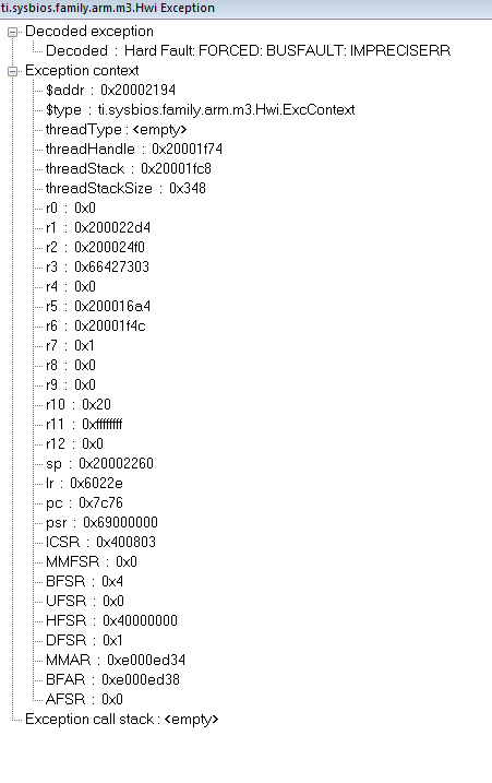

  • The ROV does not give informations on the exception:
    Can I make more tests in order to help you?
  • Sylvain,
    Can you do the modifications in
    dev.ti.com/.../debugging-index.html
    to force the impreciserr to preciserr.
    Specifically you need to add HWREG(CPU_SCS_BASE + CPU_SCS_O_ACTLR) = CPU_SCS_ACTLR_DISDEFWBUF; in your main function.
    The preciserr should contain the offending address that was written to, you should then be able to set a watch point on this address and find the offending code.
  • Hi Sean,
    I do have an offending address that appears now, but it's not in the flash, it's never the same and It's always over 0x60000000.
    So obviously I can't set a breakpoint there.
    Sylvain
