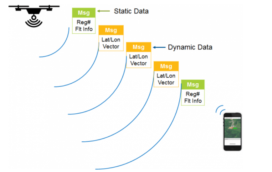

Hello Champs,
I am going to measure the accelerometer parameter and see the location of drone in a mobile app using  cc2640r2f. how can I start it? if there is an example like that can anybody share with me?
thank you
  • Hi Hari,
    I am not certain what you are asking for. How much do you know about Bluetooth low energy, Embedded programming and our SDK offering?
  •  Hello Joakim,
    Thanks for your quick reply. I want to publish location (latitude, longitude etc) data in the smartphone using cc2640r2f. I am new to the Bluetooth 5 but I'm already familiar with SDK and ccs cloud tools.
    I suggest you start by evaluating BT5 long range mode. We have a long range demo application hosted on our GitHub page where you could start: github.com/.../ble_examples. The example is written for an older SDK (v1.40) which you could port to the latest SDK (v2.40 as of now).
    However, I suggest you look into CC26x2 device instead, since it will allow more application code space. Start by understanding the BT5 functionality between two TI devices, and prototype based on that.
    I can make a long story short, we do not have any out-of-box example for your specific use case.
