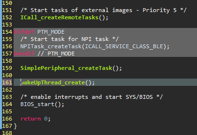

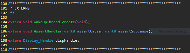

I declare the extern in main here:
and call wakeUpThread_create in main here:
Finally my questions is where in simplePeripheral or main should I call Power_shutdown(0, 0) if the device fails to connect (or becomes disconnected) for some period of time, say 90 seconds?

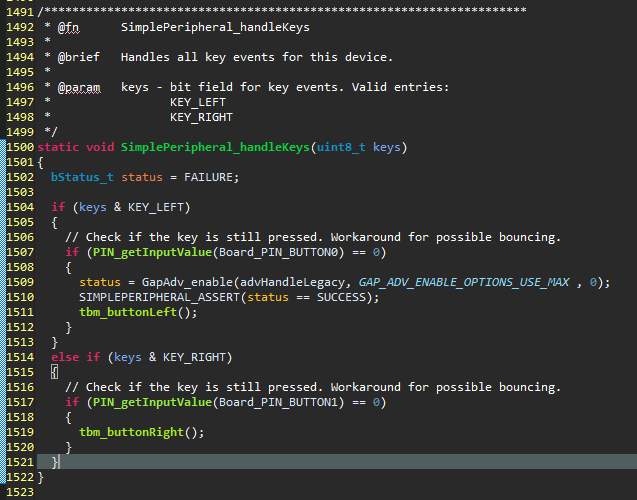

    So what I would recommend you to do is in the SimplePeripheral_processGapMessage:: case GAP_DEVICE_INIT_DONE_EVENT, to move the
    status = GapAdv_enable(advHandleLegacy, GAP_ADV_ENABLE_OPTIONS_USE_MAX , 0); to a event posted by button push.
    static void SimplePeripheral_handleKeys(uint8_t keys)
      if (keys & KEY_LEFT)
        // Check if the key is still pressed. Workaround for possible bouncing.
        if (PIN_getInputValue(Board_PIN_BUTTON0) == 0)
          //start advertising here
    Then start a software timer at the advertising enable callback, stop the advertising after timer expired(90s).
    The out of box software will start advertising when it disconnects, so you don't need to do anything more to take care of that part.

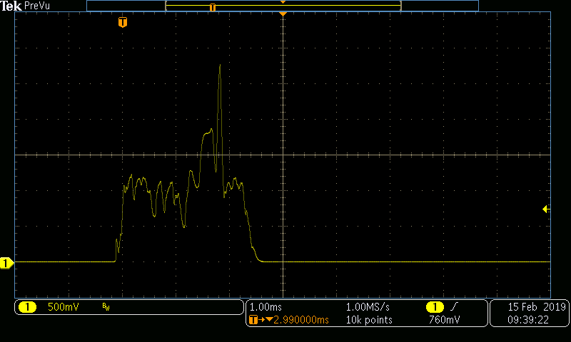

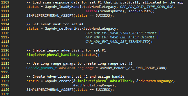

  • Thank you for the suggestion.  I implemented your suggestion as follows:
    in SimplePeripheral_processGapMessage:: case GAP_DEVICE_INIT_DONE_EVENT, I added SimplePeripheral_handleKeys(status) as shown
    and in SimplePeripheral_handleKeys I added a call to start advertising as shown below
    With these changes the 2460r2lp is not seen by the scanning device (iPhone running LightBlue) until the button is pressed - YEAH! However, the radio is still broadcasting even without the button press. I know this because I'm using a TI INA188 instrumentation amplifier in differential mode to measure the voltage drop across a precision 1 ohm resistor on the return side of the power supply. With a 100X gain on the INA188, my scope is measuring current - 100mV = 1mA.

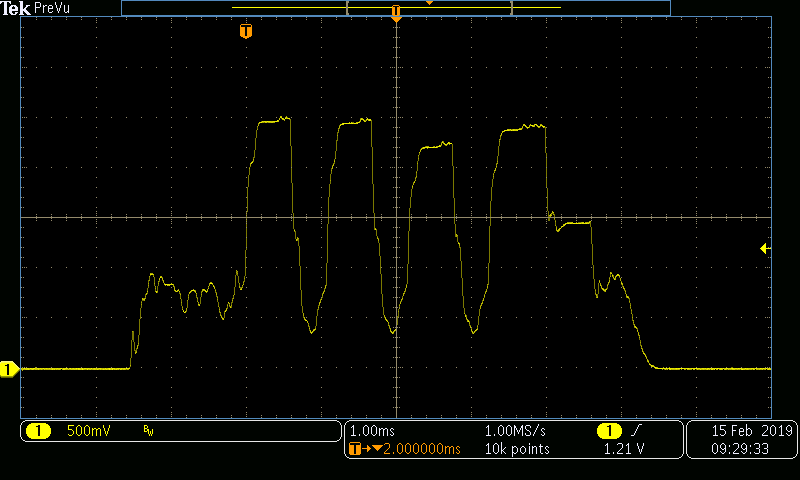

    With the CC2640r2lp turned on but not visible to my iPhone, the current draw suggests it's advertising.
    This looks the same as when I'm advertising and visible on my iPhone.
    For completeness, following is the current draw when connected.
    So, my question is, do I need to do something else to actually prevent the radio from advertising. The change I've made prevents the broadcast signal from being parsed by the client, but the signal is still being transmitted thus consuming power in standby mode.
    Patrick
  • In ble5_simple_peripheral example, it advertises in both 1M PHY and Coded PHY. When it advertises using coded phy, most phones won't see it due to it's not widely supported yet.
    Did you comment out all the code regarding Coded PHY advertisement before you run the analysis?

    After many days of experimentation, I've settled on the implementation shown below. Now, when I start the debugger and the code launches, the device is not advertising (as I intended). I press the button, and the device begins to advertise. It will stay in this state forever [status = GapAdv_enable(advHandleLegacy, GAP_ADV_ENABLE_OPTIONS_USE_MAX , 0);]. Using LightBlue, I connect to the device. When I disconnect, the device advertises for a period of time that I define then stops advertising (as I intended). At this point, I expect that the device is in the same state is was when I initiated the debug session. But the button no longer initiates advertising. Do I need to do something in SP_processGapMessage::GAP_LINK_TERMINATED_EVENT to light up the radio after the terminated connection?
    Patrick
        bStatus_t status = SUCCESS;
        if (PIN_getInputValue(Board_PIN_BUTTON0) == 1);
          status = PIN_getInputValue(Board_PIN_BUTTON0);
          SIMPLEPERIPHERAL_ASSERT(status == SUCCESS);
          tbm_buttonLeft();
