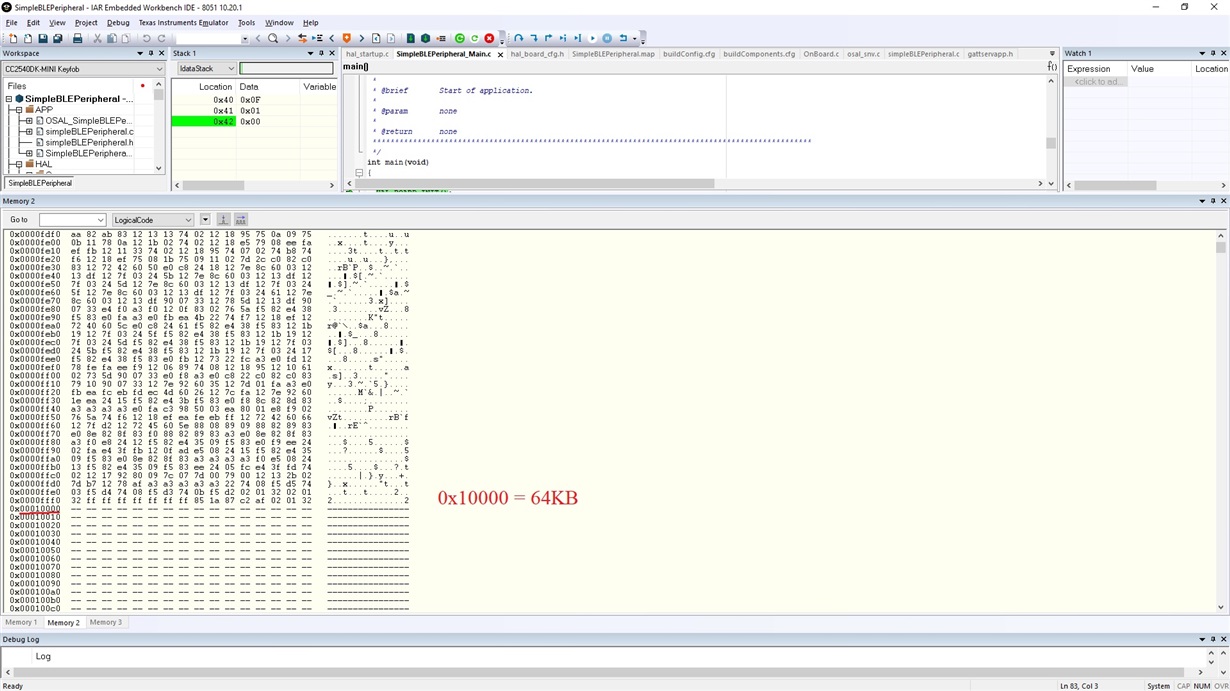

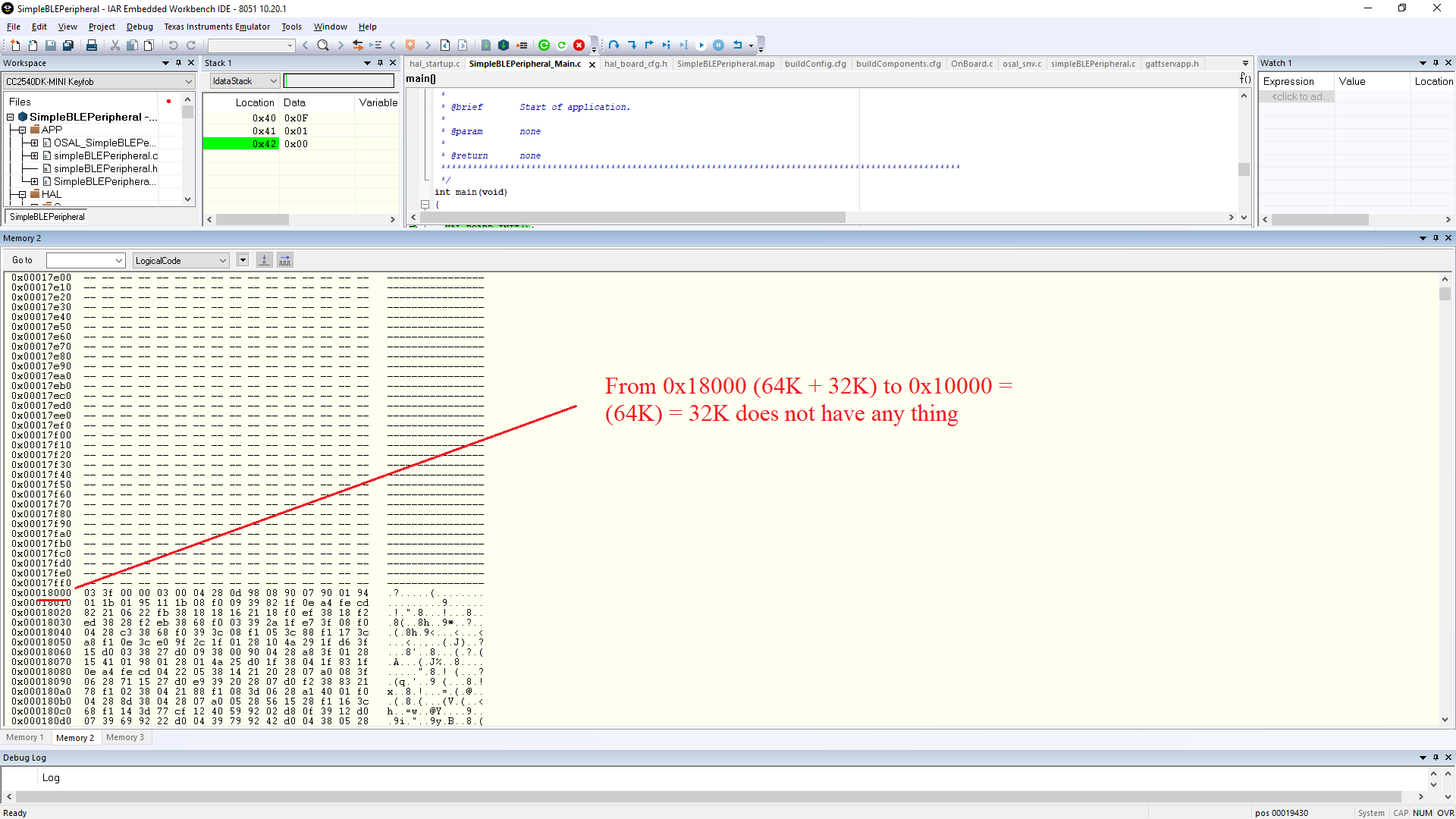

I was going through IAR memory map.
There is a gap between first 64K and next 32K. Later on every alternative 32K does not have code. Why is this. Trying to understand the concept behind this.

  • I want to use HalFlashWrite(). Trying to understand the address to be passed. Is this Logical address or Physical address. How they are mapped.
  • Hi Fredrik,
    Below is the sample code I am trying to do in SimpleBLEPeripheral_Main.c (SimpleBLEPeripheral project). But I am not able to see any data written in CC2540.

    Since I am using Page 126 and 127 (CC241 has 128 pages, 128 * 2048 = 256K), I saw memory in the range 0x78000 to 0x7FFFF. All are 0xFF.
    Please let me know where to look into Flash location and in IAR workbench memory window.
