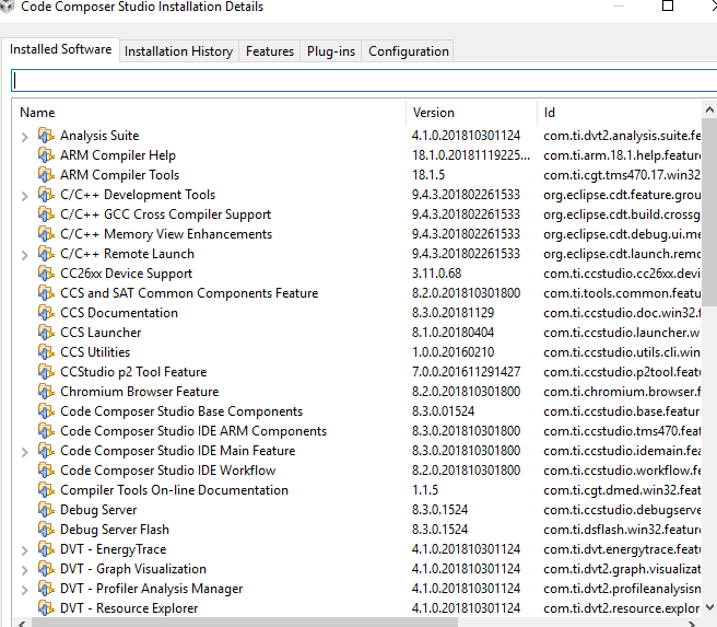

    Thanks for the reply.
    I am also using CCS8.3 with simplelink_cc2640r2_sdk_2_40_00_32.
    I looked at the my CCS Installation Details and attaches a screen capture here .
    What compiler version are you using? BTW, I am using Windows 10 with Lenovo Laptop.
    I looked at the release note:
    SimpleLink CC2640R2 SDK 2_40_00_32 was built & tested on a Windows host platform using the following Integrated Development Environments (IDEs) and components. Using an IDE or toolchain version not listed below may result in compatibility issues with this SDK release.
    Any suggestion?
    Steven
    On the release notefor SDK 'simplelink_cc2640r2_sdk_2_40_00_32', it states the test is for "TI Code Generation Tools for ARM: 8.1.4.LTS".
    My CCS ARM Compiler Tools is: 18.1.5.
    Is this correct version?
