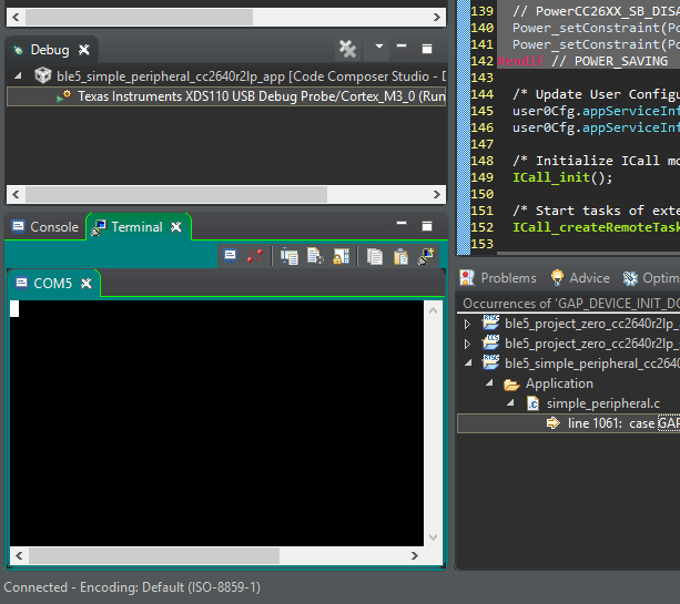

When I open a serial terminal in CCS(desktop version), I am not getting printed output from ble5_simple_peripheral. I stopped debugging, opened the serial terminal, rebuilt and started the debugging session, and no output. Other than configuring the serial connection, do I need to do something else?

    I am not able to reproduce what you are seeing here with out of box example ble5_simple_peripheral.
    Are you able to see output using terminal from other tools?
    if you have changed a lot in the software, can you provide the changes so we can better assist you.

    Finally getting back to this. Here's a little more information. I'm implementing the SaBLE-x-R2 module from Laird/LSR. They implemented the CC2640r2 in their module and sell it as a precertified BLE5 module. I would like to support display_printf() to the console. I'm following the example shown in the SimpleLink Academy - debug printing::Task4 Display_printf output to the IDE console. The implementation in the SABLEX-R2 board file with my inclusion of TI's SimpleLink example and their display code stubbed out is shown below.

    This does not display on Display_printf() on the console. I would like to see the output of the following code on the console as an example. This code snippet can be found in the SimplePeripheral example on or around line 1150.
           // Display device address
            Display_printf(dispHandle, SP_ROW_IDA, 0, "%s Addr: %s",
                           (addrMode <= ADDRMODE_RANDOM) ? "Dev" : "ID",
                           Util_convertBdAddr2Str(pPkt->devAddr));
    I've made the other few changes described in the SimpleLink Academy. Do you see anything that I've done wrong in my implementation or maybe something else that I need to do?
    Patrick
  • I forgot to declare the display in SimplePeripheral_taskFxn().  Place this code directly under SimplePeripheral_init().
      Display_Handle display;
          display = Display_open(Display_Type_HOST, NULL);
    (note HOST declaration). This code will allow your program to write directly to the "console" in CCS.
