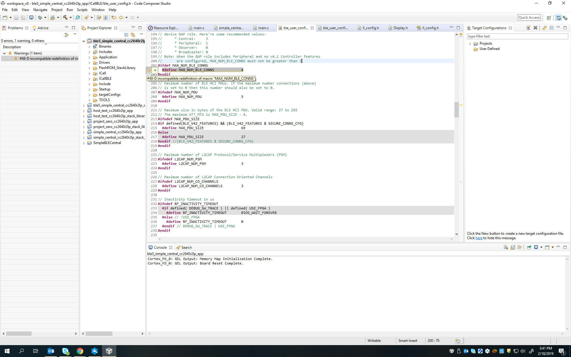

While increasing the number of BLE connections on simple central, it keeps showing "incompatible redefinition of macro MAX_NUM_BLE_CONNS" in simple central. How to overcome this?
I have attached the screenshot.
  • Hello Ujwal,
    Where did you alter the MAX_NUM_BLE_CONNS define?
    I can successfully change it in the preprocessor symbols of the application.
    Please refer to the SDK sections:
    "Run-Time Bluetooth low energy Protocol Stack Configuration"
    "Developing with CCS -> Accessing Preprocessor Symbols"
