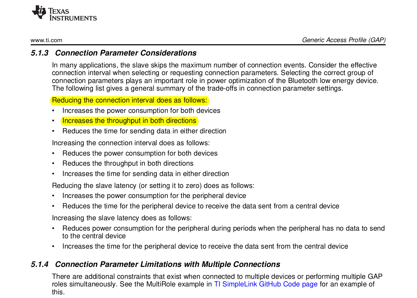

I suppose the problem is connection interval.

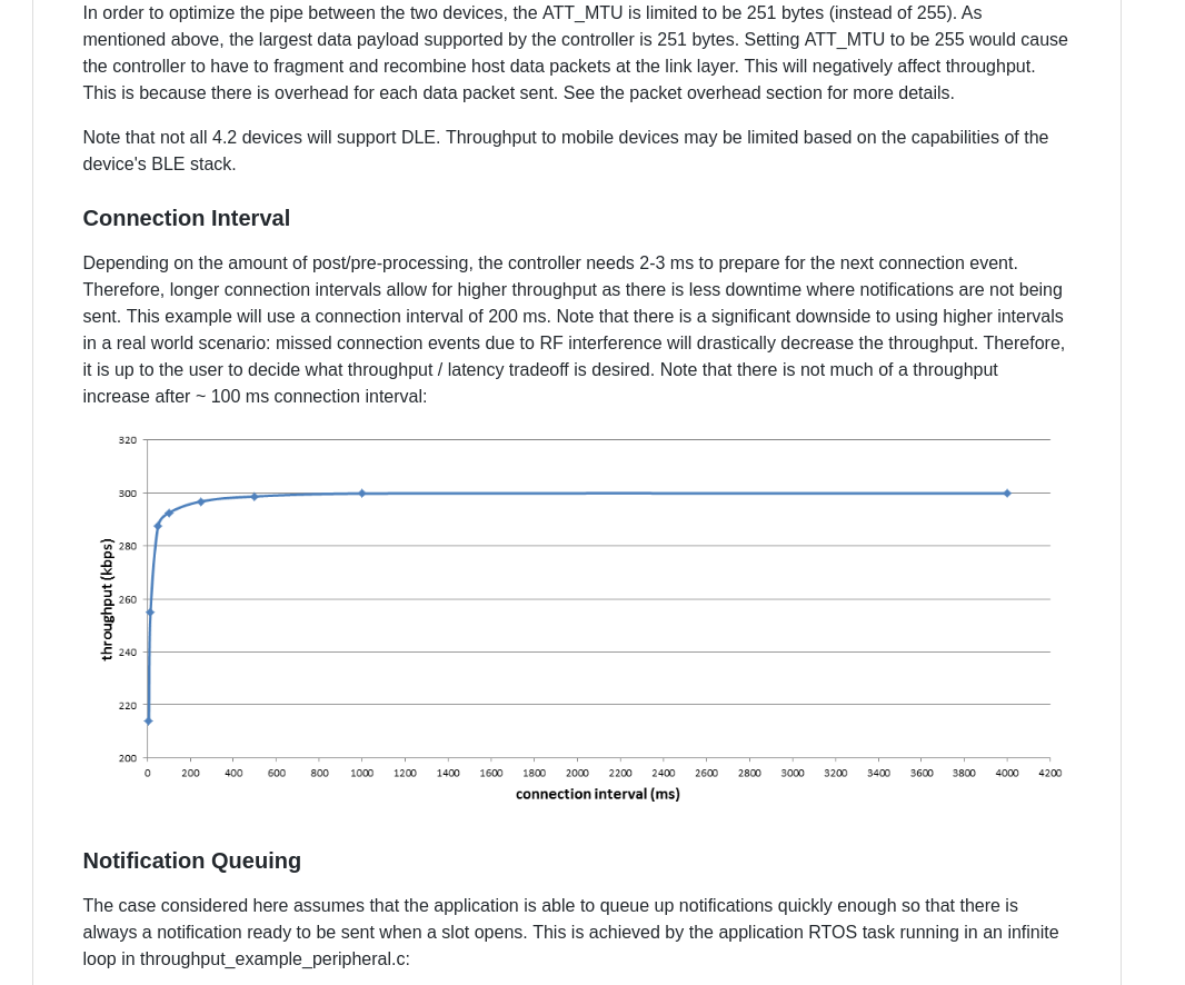

Simple_link example docs(which is the screen shot below) show that data rate can achieve 200 kbps.
With connection interval increase, the data rate increase.
However, the data sheet has a opposite description about connection interval.
Is there any difference between these "connection interval"?

    Did you successfully implement the "notification queueing" which is described in the example doc?
    Since you can send an unlimited number of packets per connection interval, a longer connection interval will give you a higher throughput (according to the graph in the example doc). Can you try using 100 or 200 ms as the connection interval?
    If you can only send a limited amount of packets per connection interval (e.g. some smartphones limit this to one packet per connection interval), a lower connection interval will give a higher thorughput.
