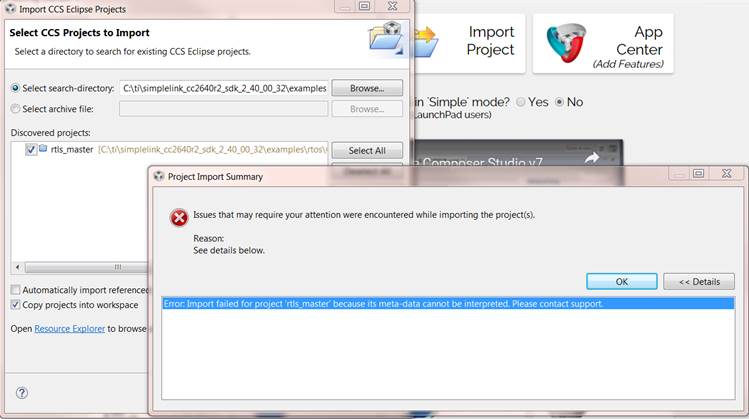

Hi Experts,
I would like to test the rtls-example but I got some trouble to include the projects: rtls_master, rtls_slave, rtls_passive.The main topic is that I got the error message to include the project: rtls_master into workspace:
See details below.
"Error: Import failed for project 'rtls_master' because its meta-data cannot be interpreted. Please contact support."
This message pop up if I push the button “Finish”.
I followed the advice of the following link without effect:
https://e2e.ti.com/support/wireless-connectivity/bluetooth/f/538/t/770218?tisearch=e2e-sitesearch&keymatch=faq%3Atrue
My CCS version is 7.4.0.

    I am not able to reproduce your issue when I import the project into CCS 7.4.
    First I would recommend you to download CCS-8.3 as it's the recommended version for simplelink_cc2640r2_sdk_2_40_00_32.
    Then after you install CCS8.3, when you create new workspace, it should have a window popped up with New Installable Produces Discovered.
    Please choose xdctools_3_51_01_18_core only and then after it's imported, the CCS will restart. You should be able to import all the projects after that.
    Please let me know if you still have trouble after this.
