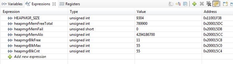

Adding HEAPMGR_METRICS I noticed that when a conncetion is enstablished  both HeapmgrMemAlo and HeapmgrMemFreeTotal are corrupted.
Before a connection is established:
After a connection is established
In order to trap the HAL assertion I added the predefined symbols :
EXT_HAL_ASSERT
MEM_ALLOC_ASSERT
and registered in the main.c the Asser Handler :
RegisterAssertCback(AssertHandler);
Forcing multiple ICall_malloc(500); I can break into AssertHandler and able to see the stackframe , so the platform is well instrumented.
Letting the Peripheral to run , I don't get any Assert when the Heap variables get corrupted .
What I'm missing ? My doubt is that somewhere on the code multiple ICall_free are called.
How I can debug ?

  • Hi Paolo,
    It's likely that some process is corrupting the heap by overwriting its bounds or also double freeing.
    It's not very easy to catch the heap corruption as it happens since any writes to memory are totally unsupervised, but it can at least be detected after the fact by adding some checks to rtos_heaposal.h manually. Once found, if you find the address where data is written when it shouldn't be you can maybe add a hardware watchpoint (maybe with data match) to get a breakpoint when the write happens on the memory bus. You should probably disable write buffering to catch this.
    See dev.ti.com/.../debugging-index.html and the debug chapter in general.
    If you have enough flash space, you could also use the RTOS HeapTrack module as the heap provider. It is designed to check for errors more aggressively, and will also show you the allocations individually in the RTOS Object View (ROV) in CCS. Please refer to the debug chapter linked above.
