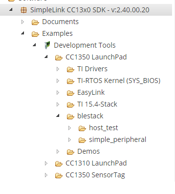

    i was search in my CCS BLE-Stack examples, there is not available in Central or Observer examples that shows only host_test and simple_peripheral examples.  i have attach my window for your reference.

  • Hello Natesh,
    As you are new to BLE and beacons in general I recommend you go through the simplelink academy trainings for BLE, Specifically labs "Bluetooth Low Energy Fundamentals" and "Bluetooth Low Energy Scanning and Advertising":
    http://dev.ti.com/tirex/#/?link=Software%2FSimpleLink%20CC2640R2%20SDK%2FSimpleLink%20Academy%2FBluetooth%204.2%2FScanning%20and%20Advertising
    Also please review the Bluetooth low energy Beacons Application Note (SWRA475) for more information about Bluetooth low energy beacons. TO change to beacon you simply need to change the advertisement payload.
    We do not provide a simple_central project fro CC1350. You would need to port the project from a CC2640R2F project and w do not have a guide for this that I know of. But you can use the host_test code with BTool to emulate a central device for testing (set up connection, read rssi, etc.).
