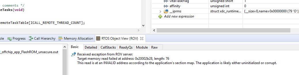

during development of the current project, some strange behaviour of the firmware is observed, i.e. bonding seems not possible. To find out root cause I wanted to look into RTOS Object View in CCS but get an error message in the window:
"C:/ti/xdctools_3_50_08_24_core/packages/xdc/rov/StructureDecoder.xs", line 518: java.lang.Exception: Target memory read failed at address: 0x20003414, length: 32This read is at an INVALID address according to the application's section map. The application is likely either uninitialized or corrupt.
I can read out the address with the memory browser
What do I need to do to look into the RTOS view? What other investigation do you recommed to guarantee the sanity of my firmware?

  • Hi Harald,
    It looks like there is some corruption going happening on the target. Have you ruled out stack overviews? That a look at this video/presentation to see how to do this: training.ti.com/debugging-common-application-issues-ti-rtos
    Does everything in ROV look ok in main()?

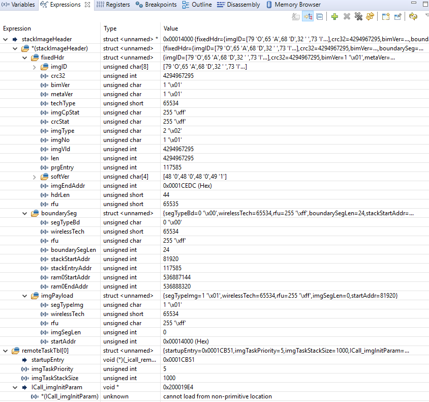

    The ROV view gets defective after calling
    task = Task_create(ICall_taskEntry, &params, NULL);
    in
    void ICall_createRemoteTasksAtRuntime(ICall_RemoteTask_t *remoteTaskTable, uint8_t nbElems)
    I used BLE Peripheral OAD off chip as start project. When I understand correctly, this functions starts task in stack image. Therefore it retrieves all information about task within function findStackBoundaryAddr();.
    This looks good, it seems to find the correct image and header:
    When I look into map file of stack images this seems correct:
    OUTPUT FILE NAME:   <XXXXX_cc2640r2lp_oad_offchip_stack_FlashROM_unsecure.out>
    ENTRY POINT SYMBOL: "startup_entry"  address: 0001cb51
    But after calling     task = Task_create(ICall_taskEntry, &params, NULL); in ICall_createRemoteTasksAtRuntime the ROV view is empty.

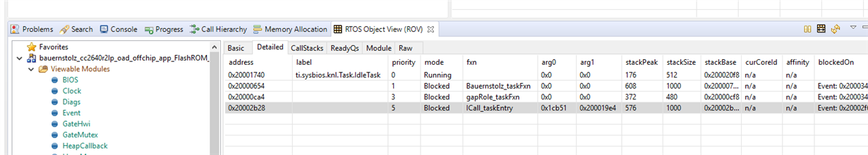

  • OK, I probably got this one: My stack image was outdated. I needed to flash the current stack image, now the ROV view seems normal:
    My main problem remains, I am still unable to pair / bond / encrypt. I hope to be able to describe my issues in more detail in order to get help...
    Harald
  • More likely than the outdated stack it seems that I need to add symbols from BIM and stack project in the debug session. Is that possible?
