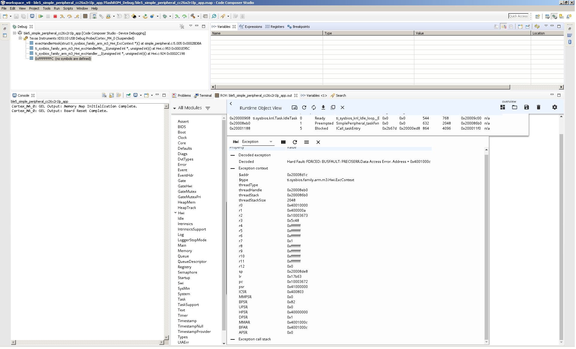

I need help fixing a PRECISERR.Data Access Error that is happening in my ble5 simple peripheral project. I am using version 2.3 of the simplelink cc26x2 sdk. I have been trying to track down the problem following the debug guide up to the point where the exception information is inspected using ROV ( ). I have implemented a execHandlerHook method and the program eventually ends in that method. Unfortunatelly, I do not know what to make of the ROV data I can collect at this point:
Can anyone help me interpreting it?

    The error is that you are trying to read from GTP0::CTL before that peripheral is turned on. Busfault address is 0x4001000C. Please see dev.ti.com/.../CPU_MMAP.html for reference
    Based on the PC (0x10003672) it looks like the function that caused the issue is TimerConfigure() from driverlib in ROM. You can find this if you load the driverlib.elf symbols via Run -> Load -> Add Symbols -> Browse -> <sdk>\source\ti\devices\cc13x2_cc26x2\rom\driverlib.elf and then look in the disassembly. Your LR is somewhere in Flash so I can't tell you what function called TimerConfigure.

    Your first screenshot was more helpful, as it shows the register contents at the time of the exception. This is stored by the CortexM itself, and displayed by ROV. In your last screenshot you show the current CPU state while you are in the exception handler. Usually not very interesting.
    I "knew" it was a read because it was a PRECISERR and I assumed you had not disabled write buffering (see debug chapter in the sw dev guide). Since write buffering is enabled by default you will I think always get IMPRECISERR because the exception happens after the program counter has moved on.
    The PC was an address in the 0x10million space, which is ROM. Since you were using 2.30 I assumed you were using the _v1 revision hardware and so I added the driverlib symbols to CCS, then used View -> Disassembly menu in CCS to look at that address (using the input box at the top to enter the address). Full disclosure, I also tried _v2 but that did not make sense.
    Now two things are pointing to GPTimer misuse; the busfault address, and the instruction at the excepting PC which is inside TimerConfigure(), and which is also a load instruction (read).
    You can look up the LR in disassembly view also. In addition, if the driverlib symbols are loaded before the failure, as well as the RTOS symbols (somewhere in <sdl>\kernel\tirtos\packages\ti\sysbios\rom\cortexm\cc26xx), the HWI ROV module will sometimes be nice and give you the entire call graph at the time of the exception. Usually you'd want to use the _Debug build configuration which puts TI-RTOS in Flash instead of ROM and adds some extra checks.
