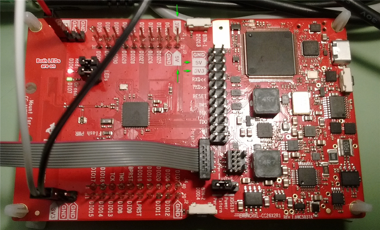

How do I lash in the JLINK? What documentation there is on the launchpad says to remove all the jumpers and used the Target-In connector.
I get the following error when trying to debug:

  • I have no problem to use JLink to debug CC26X2R1 on LAUNCHXL-CC26X2R1. Make sure you remove all jumpers between XDS110 and CC26X2R1 on LAUNCHXL-CC26X2R1. Also do remember to give power from 3V3/GND pins with external power supply.

    I have attached a photo of my set up.  I have confirmed voltages on the pins indicated.
    I have tried an example with the main(0 gutted, and still no go.
    I am trying to look for the frequency setting.  In Segger studio, it is set to 8MHz.  But I take the default settings on the EK-TM4C1294 board and am able to connect.
    Thanks for any insight you have.
  • Your connection looks good. Can’t you get it work?
